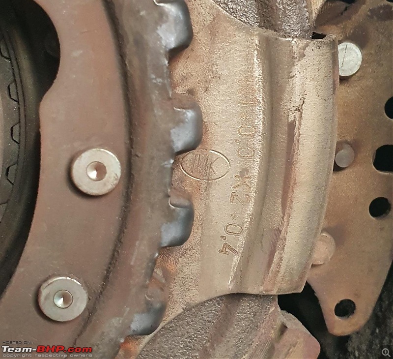

Luk is the OEM supplier for this part as evidenced by the OE clutch of my Polo. DSG FIX - Multiclutch replacement of the DQ200 on my VW Polo GT TSI-img20210611wa0068.jpg
Closeup shows the faint LUK stamping on the dual clutch.

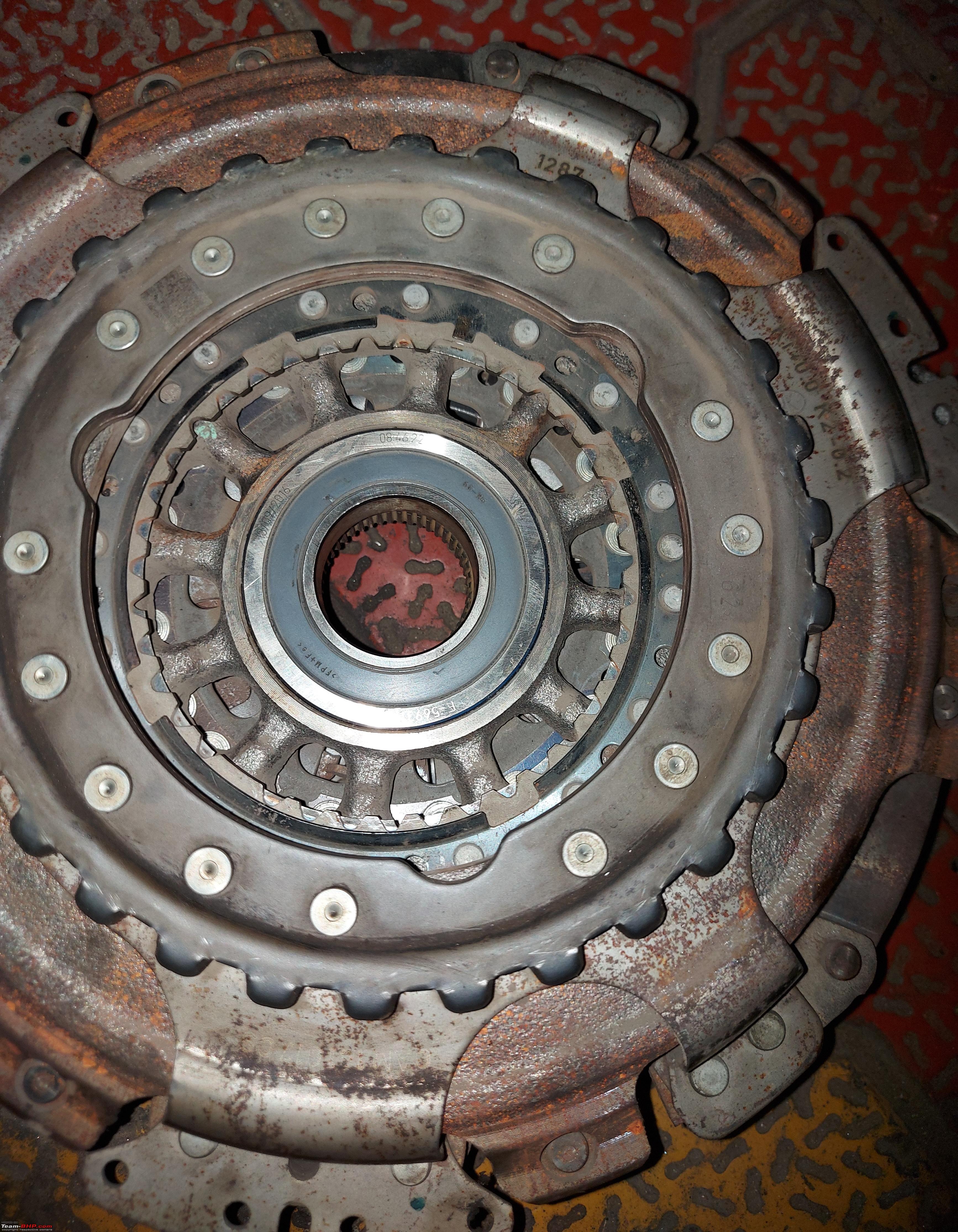

The various bits of the clutchpack removed
DSG FIX - Multiclutch replacement of the DQ200 on my VW Polo GT TSI-img20210611wa0062.jpg
The worn out fingers of the clutch.

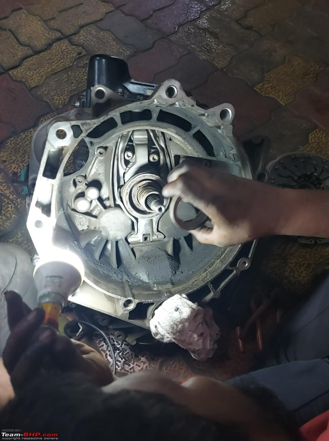

Huge amount of debris in the bellhousing. The temps must have been pretty high in the GB because one of the shifter forks has plastic supports for a bearing, and that was not there on the fork that was removed!
DSG FIX - Multiclutch replacement of the DQ200 on my VW Polo GT TSI-img20210611wa0061.jpg
The housing after it had been cleaned up with compressed air, and then washed with petrol and a small brush. In this, the small fork and bearing have been installed already.

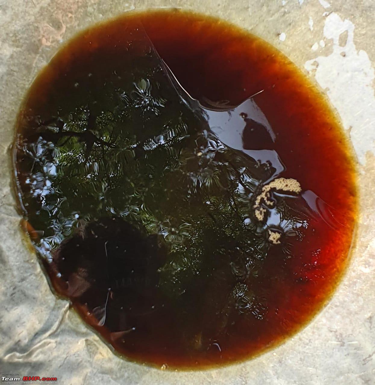

Pretty black for something that's supposedly sealed for life. Not sure what the term means though, since there is no definition of life - is it the till the transmission breaks? Is it till the end of time? rl:
None of the guides mentioned that the gear oil will leak out through the breather cap, and I didn't think to drain the oil before. So most of it leaked out onto the ground (can be seen in some photos). This is a special gear oil for the DQ200, so I had to get it via countersale at VW itself. The capacity is 1.9 litres and needs to be filled from the breather port.
Note: this transmission has two oils, one for the gearbox and one of the mechatronic. I also went ahead and topped up the mechatronic fluid, luckily I managed to find the right fluid in the aftermarket.

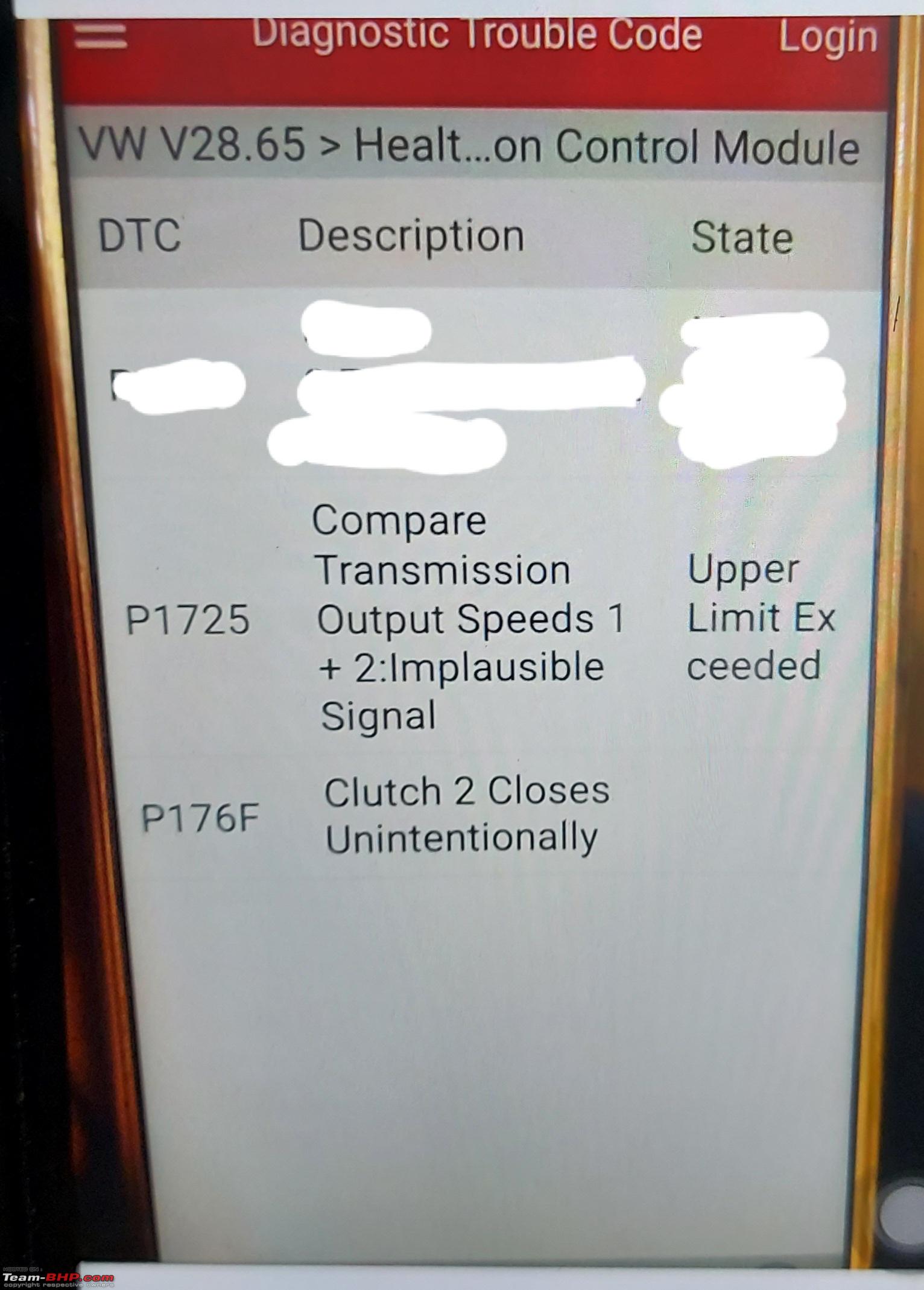

Observations on Scanning - Round1
Error codes P1725 and P176F shown below

A second scan threw up an additional code P177C
DSG FIX - Multiclutch replacement of the DQ200 on my VW Polo GT TSI-errorcode_transmission_vwpologttsi.jpg
I think the owner had already seen his pockets getting empty and decided to take the car in this state. Damages were to the tune of INR 75k; so much for a car that had just 75k kms on the odo.:)
Implasuble output signal is usually related to the speed sensor but also comes up when the clutch is failing. I had similar trouble codes.
The other two codes (Closes unintentionally and Tolerance Limit reached) I had on my car for the past 8-10k kms and it was driveable, but I knew it would give up any day.
I hadn't planned on spending 70-80K on the car like this either, but VW's change/realignment in warranty policy left a lot of us in the lurch when we had been banking on it. :sadface
