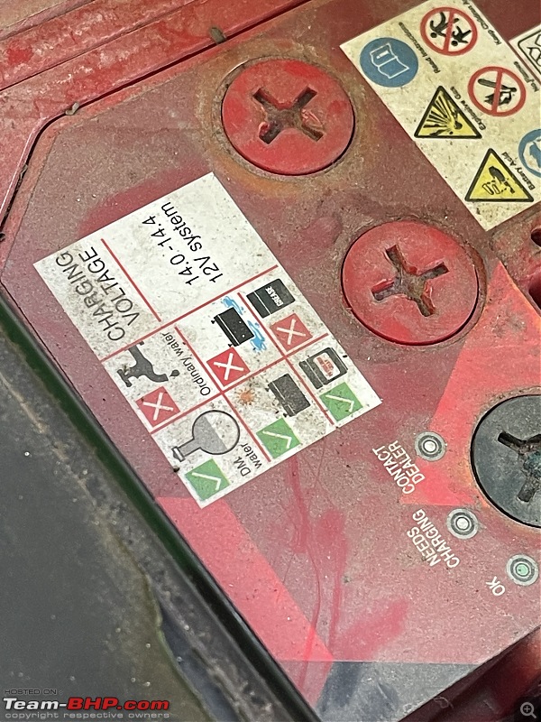

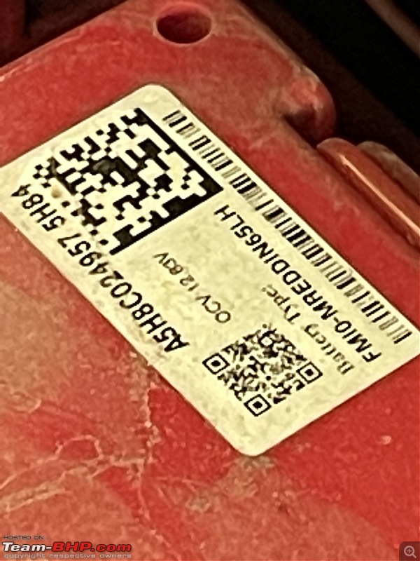

Posting a request for advice here.
Here is the background.
My 2012 Mini Cooper S originally must have come with the BMW OEM Factory Spec 70AH Battery. When I git the car 3.5 years ago in 2019, it had an Exide 65AH which is being used presently.
The previous owner put this in, in 2018. Now it is 4.5 years. In the time that I have had this car I have clocked about 26000kms in it so perhaps this Exide battery overall may have done 30-32000kms in the 4.5 years of its life. Typically these batteries come with a 55 month warranty and I am just about reaching the end of that.
Of course my Car’s original recommendation is that we have to use 70AH Battery. So I ve been doing some research on this.
I went to two of my local Battery shops. One had predominantly Exide branding and the other has Amaron Branding but both sell both Exide and Amaron. They checked the battery with the Meter and we saw it was delivering 12.2 volts when idle. When the car is switched on and started it jumps to 14.4 volts.
So it seems to be fine.
However, now that it is 4 and a half years old we opened the little dipstick and checked each cell. (I did this 3 times- at the Exide Shop, at the Amaron shop and again at the Car AC mechanic’s place.) I notice that one cell (the third cell on one side) has weakened so I believe as a preventive measure it is time to change the battery. I prefer to be pro active rather than reactive in these matters. So the local shops have the 70AH battery and I plan to be getting one fitted shortly. The Exide 70AH costs 10,000/- and they are giving me 2000/- off for my old battery in exchange, so the nett cost will be 8000/-. As per the shop chap Amaron does NOT have an equivalent 70 AH.
In the meantime, over the last ten days, knowing very well that my battery will require changing soon, Ive been checking on OEM/ OES batteries.

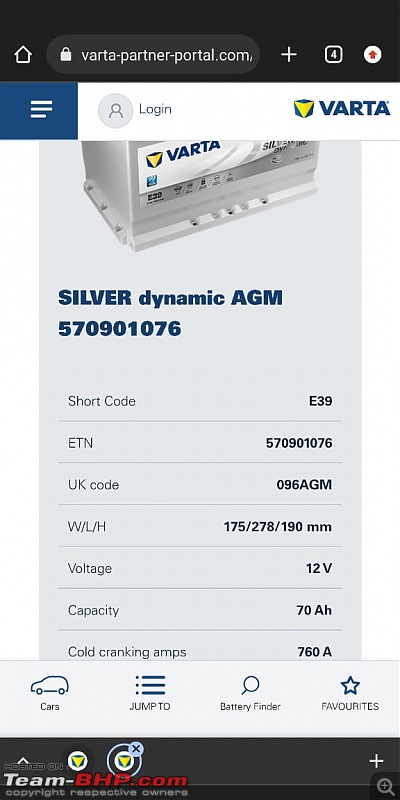

The Varta 70 AH Silver Dynamic AGM E39 is an OEM/ OES battery for BMW cars.This can be got from Delhi from the Authorised Importer M/s BIECO Batteries somewhere in Vishal Enclave wherever that is. They will reach the battery to my door step in Bangalore in 6 days. It costs 25800/- including shipping. I then checked with BMW too. The price of the AGM E39 battery at BMW is 36000/-. Plus around 3000-4000 for removing, refitting and ‘programming’.
I checked then with my FNG, Aeon. And I also did some level of online research on North American Motoring etc - these are good information sources for Mini Cooper.
The upshot of it seems evident that it isnt really necessary or mandatory for me to go only for an OEM or OES replacement. I could very well go for any good quality substitute brand of equal Amperage.
The vehicle has actually been running with this Exide of a marginally Lower Amperage of 65AH for the last 4.5 years and its worked fine. So I guess it ll probably be fine if I just go for a brand new Exide of the correct Amperage of 70AH.
Frankly I personally don't mind spending and getting that Varta AGM Silver E39 from Delhi.
But Im asking, is it absolutely necessary that I opt for this, which is at more than 3 times the cost of the Exide?
Does anyone here have any views and suggestions on this subject?

If you are keeping the car then an AGM unit might be worth considering. Else go for the Amazon!
