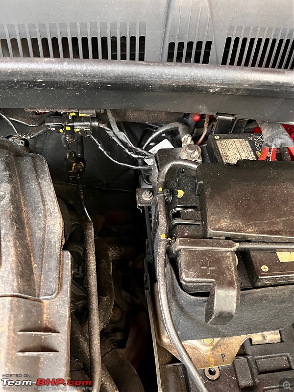

Hello All,
I got my new Kushaq 1.0 TSI MT delivered in the last week of April,22. Due to continuing work-from-home scenario, it has run close to 1500 kms so far.
I drive it to my office once in 10-15 days. For the last two months, it has been standing idle except 5-10 minute ride in my apartment basement every 15 days (in the hope that it shall keep the car battery alive). Y'day night, when I tried to take her out, I got the following message on the console -
Your car has a low battery. The system will shut down soon.
After this, the car was shut down, and now there is no display whatsoever. I'm really puzzled as to how can the battery of a new car die so soon. Or is there any other issue with the car? What should be my course of action? Has anyone else come across similar issue? Please share your valuable input.
Thanks.
