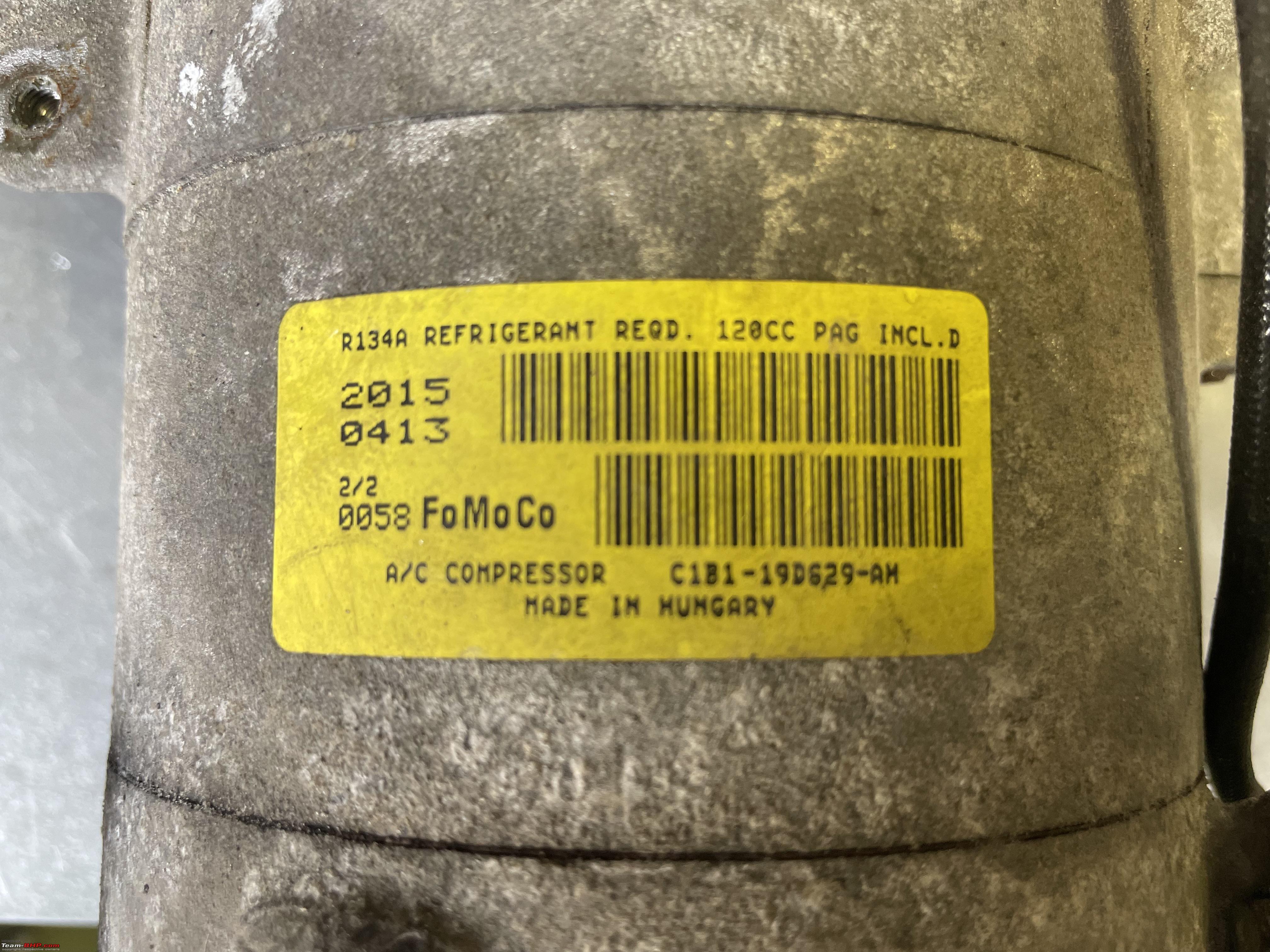

It is important to know whether your new compressor has already oil in it or not. Each AC system takes a very precise amount of lubrication oil. So if the compressor is already filled, you need to add less. When filling, or rather recharging as it is known, the system, you add refrigerant with the correct quantity of lubrication oil and a dye. The dye allows for easy leak detection.
In your car workshop manual it will mention how much oil needs to go in the system and also how much oil each main component will hold. (e.g. the compressor, the dryer, the evaporator etc.) So if you replace one component you have some idea on how much oil to replace as well
Always good to check the type/model plate of your compressor. As you can see this is an original Ford Motor Company compressor. It was made in Hungary in 2015 and it takes R134A refrigerant. R134A is more or less the default type of refrigerant these days.

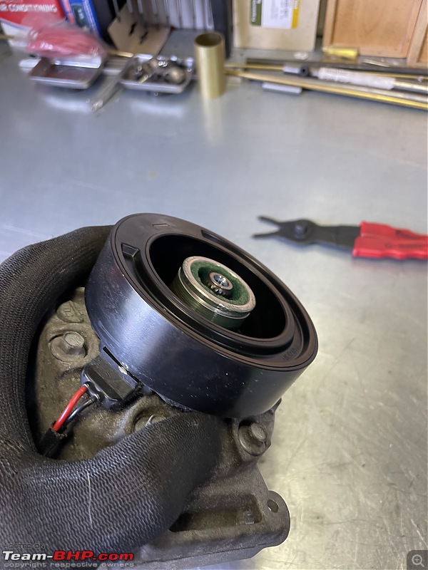

A closer look of the clutch at the front of the pulley:
Anatomy of a Car AC Compressor (clutch/variable)-img_1921.jpeg
Here you see that electrical lead going into the electromagnet.

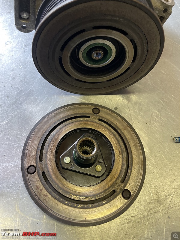

Here you see the inside of the clutch pate. When activated the electromagnet pulls it towards the pulley. So the clutch plate goes directly on the pulley! Notice the bearing in the centre of the pulley. Without the clutch being engaged, the pulley just free wheels and the compressor is standing idle, whereas the pulley still spins, driven by a V-belt, similar to your alternator.
Notice that the clutch plate centre piece has splines on it, that fit on corresponding spines on the compressor shaft. So the clutch is attached directly to the compressor shaft, the pulley freewheel on the shaft, until the clutch engages.
Anatomy of a Car AC Compressor (clutch/variable)-img_1925.jpeg
The clutch plate seen from above. It is the actual clutch plate with a spring attached to a smaller plate. The electromagnet pulls the clutch plate and when it disengages the springs pulls it off the pulley. Only a few mm. The gap is a good indication of the wear of the clutch. On my Jeep I replaced the bearing and on an earlier Jeep I had to replace the whole clutch too as it was worn out. To thin and the electromagnet won’t be able to pull it against the pulley tightly anymore.

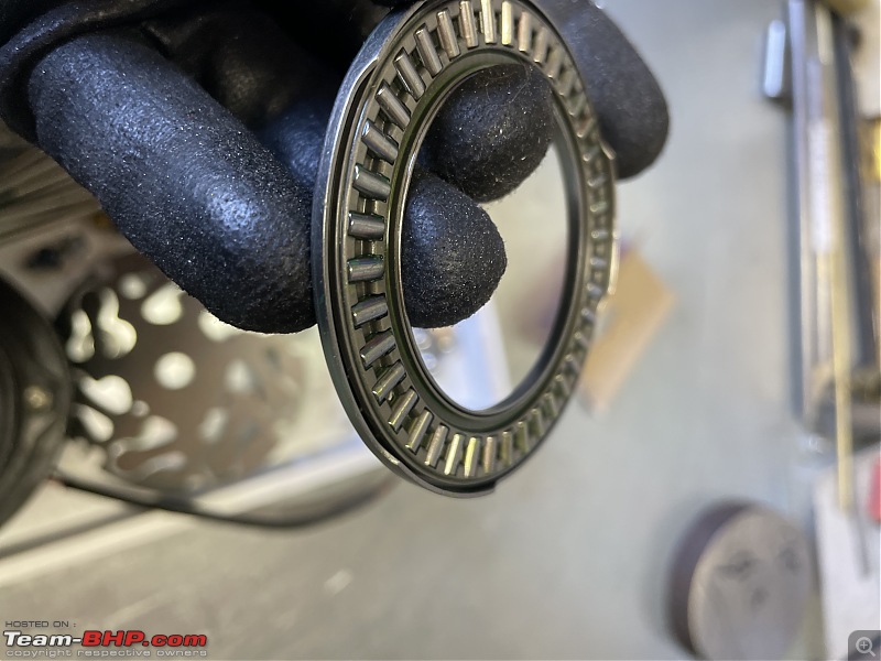

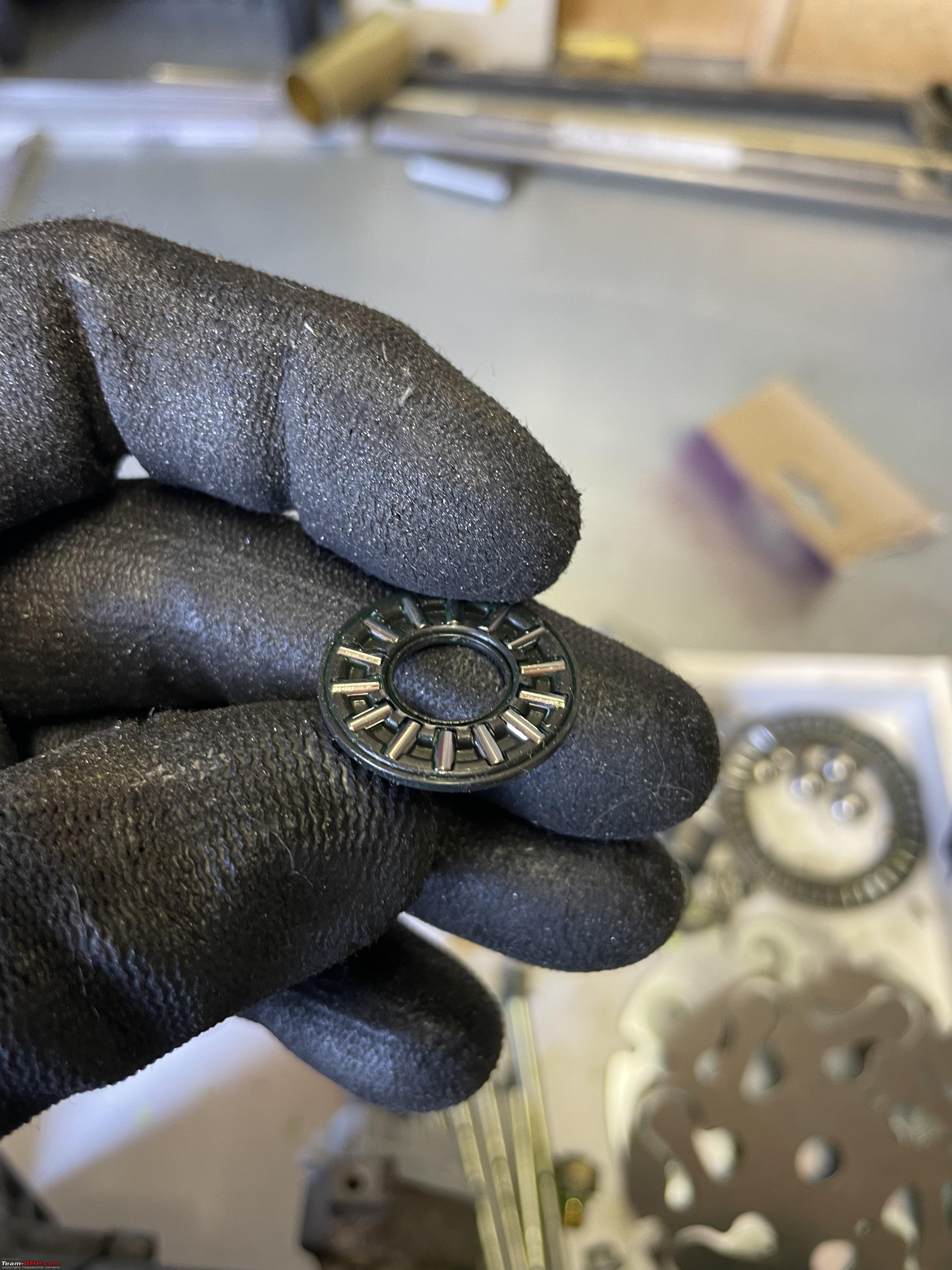

Anatomy of a Car AC Compressor (clutch/variable)-screenshot-20230619-10.51.59-am.png
Two of the needle bearings that have come out.
Anatomy of a Car AC Compressor (clutch/variable)-img_2058.jpeg
