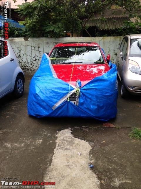

Further to my 27th July post, I got my "Oil Sensor failure" issue fixed from Audi South Mumbai and this time the bill was for Rs 5000 odd. The car returned on a Thursday 1 August. I parked my car at a different spot, till Saturday evening and returned to the same spot on Sunday. Driver kept 2 packets of napthelene balls at various places inside the engine. Doused the engine with phenyl. Unbelievably, the dreaded " Oil sensor failure" indicator lighted up once again on Monday the 4th August. Called up Audi and poured my heart out and they promised that they would grease up the under carriage,so that rodents are kept away. In the meanwhile, I also ordered the Rat spray from Autoshine Kandivili.
This time I forced Audi to let my driver evaluate where the issue was and he states that 'the sensor is a tiny Nokia charging pin kind of a protrusion with a thin wire of no coating " which must be snapping when the rodent passes/pushes it. So there is hardly any chewing happening inside my car.
Post 3rd time repairs, the service guys refused to grease the underbody, claiming that their service centre is under surveillance with direct link to Audi Germany and they wouldn't allow such a thing. I gave the guys a piece of my mind along with loads of emotional blackmail ( which only got me a free interior cleanup during my 1st service which will happen in 6 month). The damages were Rs 7000 odd this time.
Not wanting to take anymore chances, below is one idea that I came up with.
Cost of Tarpaulin Rs 2100.
Cost of Ropes, etc: Rs 200
That night, the damned rodent chewed up the tarpaulin too. Made a little hole through the double layer, but there seemed to be no inside entry sign. In the meanwhile, the spray from Autoshine also arrived. Sprayed it to my hearts content in the engine bay and also through the front tire gaps. It smells of Chandan and has a pretty strong smell. I forgot to cover up my nose while spraying and did get a bot buzzed by the fumes. Patched the tarpaulin, and wrapped the car again last night.
Checked this morning and there was no sign of any new damage to the tarpaulin.
Looks like the spray is working.
Oh my GOD!!
Rodents have truly got you to try all sorts of things to keep them away. This is the first time I am trying to see such an attempt to keep them away.
Rodents mostly get into the engine bay by climbing up on the wheels, don't they? So, instead of blocking the whole underbody of the car, won't just putting a slab or something of a significant height on the inner side of the wheel from where they climb, or blocking the entry point using something made up of metal make sense? Just my thoughts and I might be completely out of place here.
All I can do is wish you luck with the rodents!
Amazing! A car undercover!
But, if it works it works. Good for you!
[/quote]
That sound like remarkably bad engineering for VAG group car!
You might try Sugru as a reinforcement. Not cheap, but cheaper than rat damage. Mind you. I don't know that rats don't like the taste.
