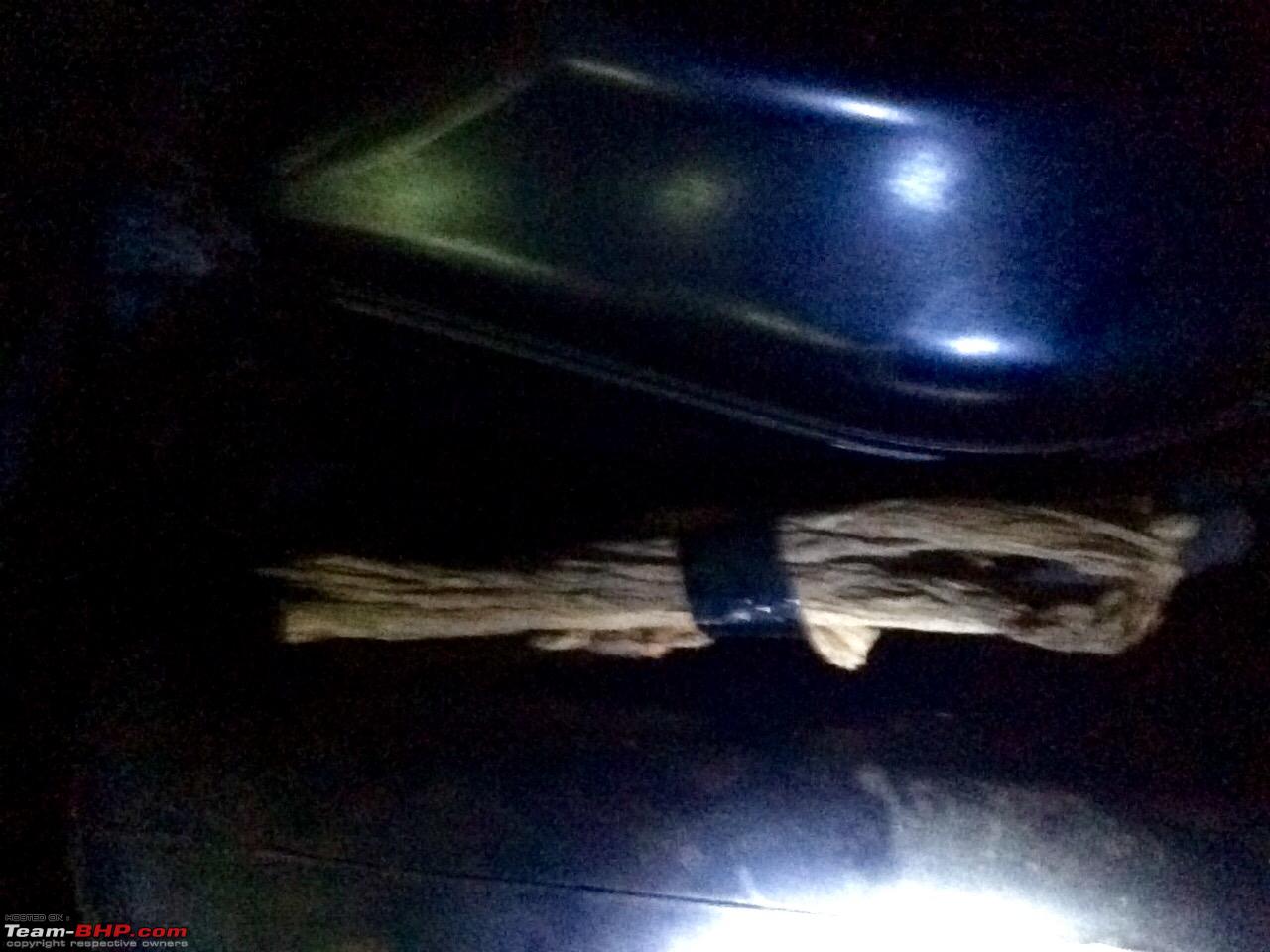

I've had stinking rats chewing up my battery cables and distributor wires. I tried chewing the cables myself but couldn't imagine why its irresistible to rats.
Now I find 2 methods which keep the rats away.
You need to buy tobacco leaves. These are about 1 feet long and any shop selling pooja eqpt. will have them. Each costs Rs. 8 to 12.
Just tie them to your Petrol pipe, battery cables, distributor cable and brake lines. It's too much effort to tie them to every single cable. I kept it for the ones without which the car can't start or move.
They should last about a couple of months.
I love the tobacco smell. But Rats can't stand this smell. And will avoid your car.
One more method is to put black pepper powder around your car park on the ground. Like a Lakshman Rekha. This would get blown away by the wind. So needs frequent refreshing.
Last method, if none of this works for YOUR rats, weld a close gap metal mesh to the bottom of the engine Bay.

I've tried the tobacco leaves trick and it has worked for me quite well. I think I picked up the trick on this thread itself sometime back
However, looking at the method some of you have described in the recent posts, I have a word of caution.
These tobacco leaf bundles are quite dry. They keep getting dry with use and of course keep losing their effectiveness too. I would be very wary of taping a bundle of dry tobacco leaves anywhere in the engine bay given the temperatures that can be reached. God forbid, what if it catches fire !(I'm paranoid ). These leaves are after all very good at burning up, just look inside any cigarette !
To get around this, every night I used to just place a bundle on either side of the engine bay, near the suspension stoppers. And remove them dutifully when taking out the car next. In fact, I used to think twice about placing them in the engine bay after a long drive when the ambient temperatures were still very high.
Of course, it is tedious, but I consider it a small price to pay for peace of mind.
