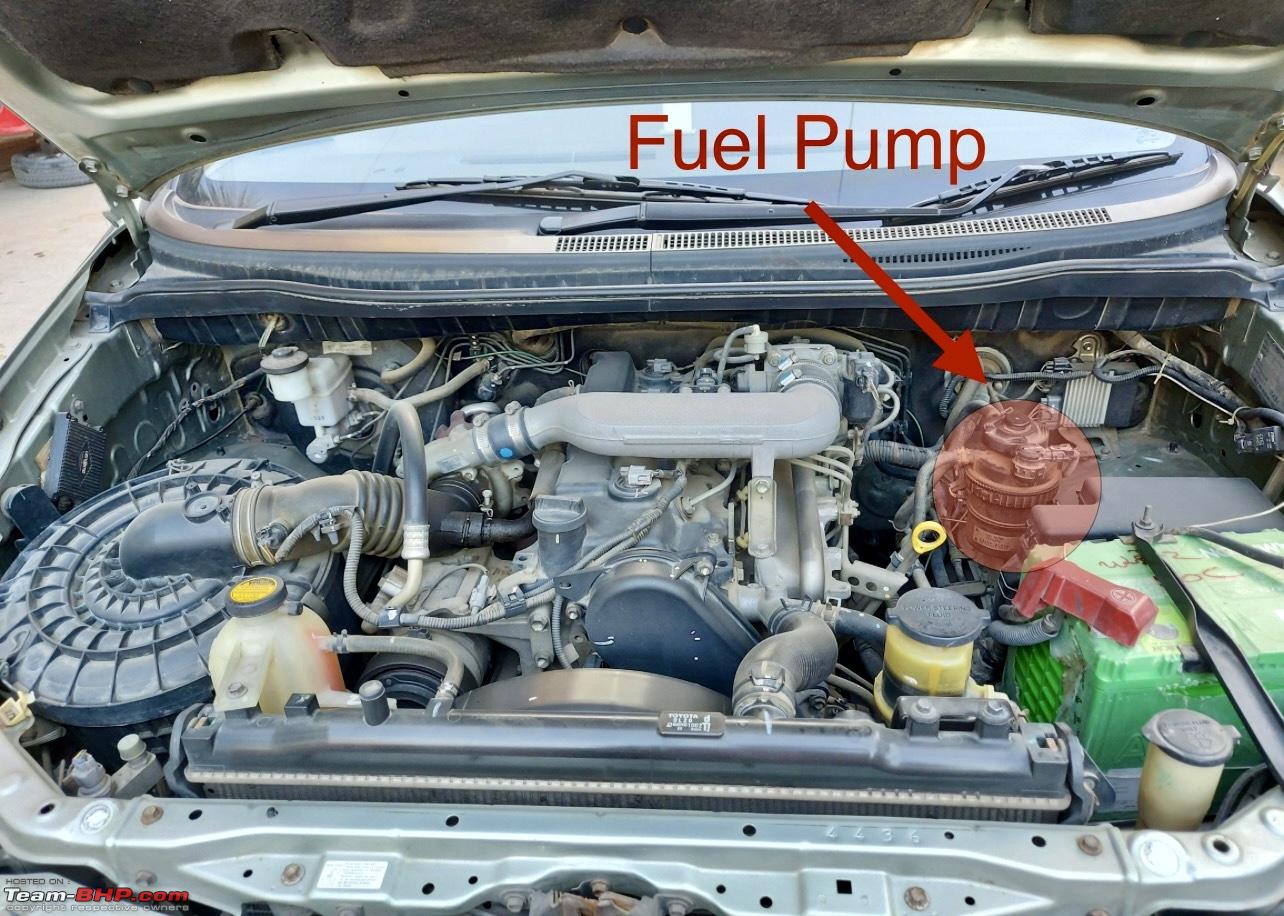

Toyota is generally known to be reliable, but my Innova once left me stranded due to the DTE figure shown. I have a habit of refuelling whenever it drops below 90 km. One day I didn't follow that and was going to refuel around the 50 km mark. Car died on me when it had 60 km of DTE left. Just a minute before, I could feel the throttle response lagging, and the next minute, the car died on me. I had to call my dad, who was 10 minutes away, and soon called the SA. He advised checking the fuel pump condition, and he diagnosed that I had essentially run out of fuel! After getting an earful from dad, I went on to the nearest fuel bunk and refuel it. After refuel, had to keep pumping the fuel motor to start the car. A good lesson to never rely too much on the sensors!

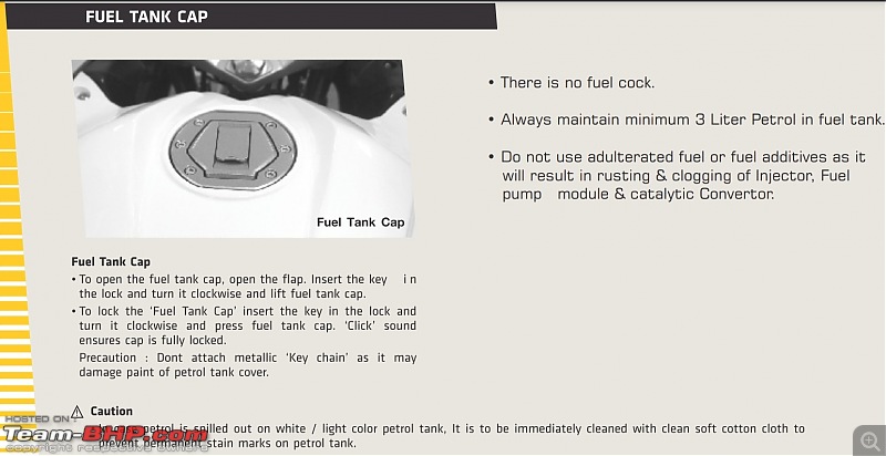

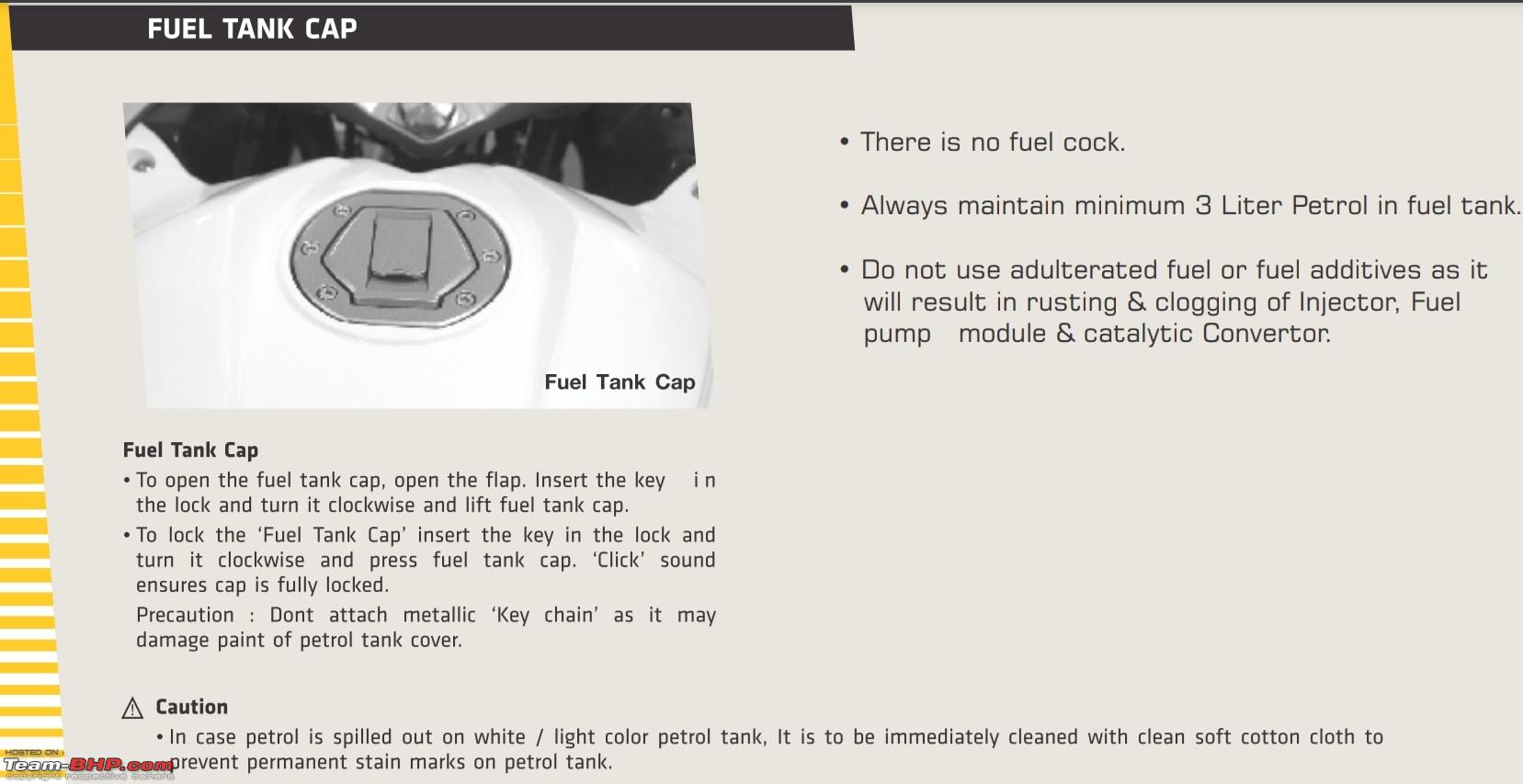

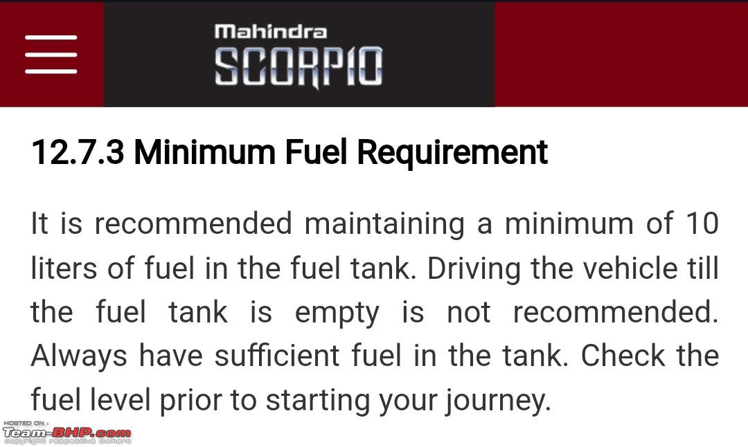

It should not! You should be able to get almost the last drop out of the tank. The suction inlet pipe in the tank is usually set in a little recess in the fuel tank. So you can literally suck the tank just about dry.
I have read in the thread on Tata Safari Issues that rpm needle started fluctuating when the car was run low on fuel and it went away after fuel pump replacement. This is where my knowledge on fuel pump failure is coming from. I haven't experienced it myself.
I think that a car sees many inclines and declines and running low on fuel may keep the fuel pump occasionally less submerged or even allow air to get sucked in, which will cause the damage. It could be a wrong understanding.
A small 12 litre fuel tank motorcycle manufacturer recommends that you should keep at least three liters in the tank. A 60 L tank car recommends that you should keep 10 L always in the tank. Both the references are attached. The tank listed capacities may be slightly different, I didn't search for them.
This is where my recommendation of not listing actual fuel volume is coming from. If one knows that there is 3L remaining, he will try to delay the refill. In commonly used motorcycles, 3 L means 10 days of 10 km/day ride.
In cars, going to three liters will cause some damage somewhere, which forces companies like Mahindra to recommend 10 L. They don't know that many cars in India haven't seen the tank getting filled by more than 10 L throughout there life.
Ironically, I have not received any vehicle with more than 10% fuel in the tank. You are usually compelled to drive directly to the nearest fuel pump after taking your vehicle's delivery.

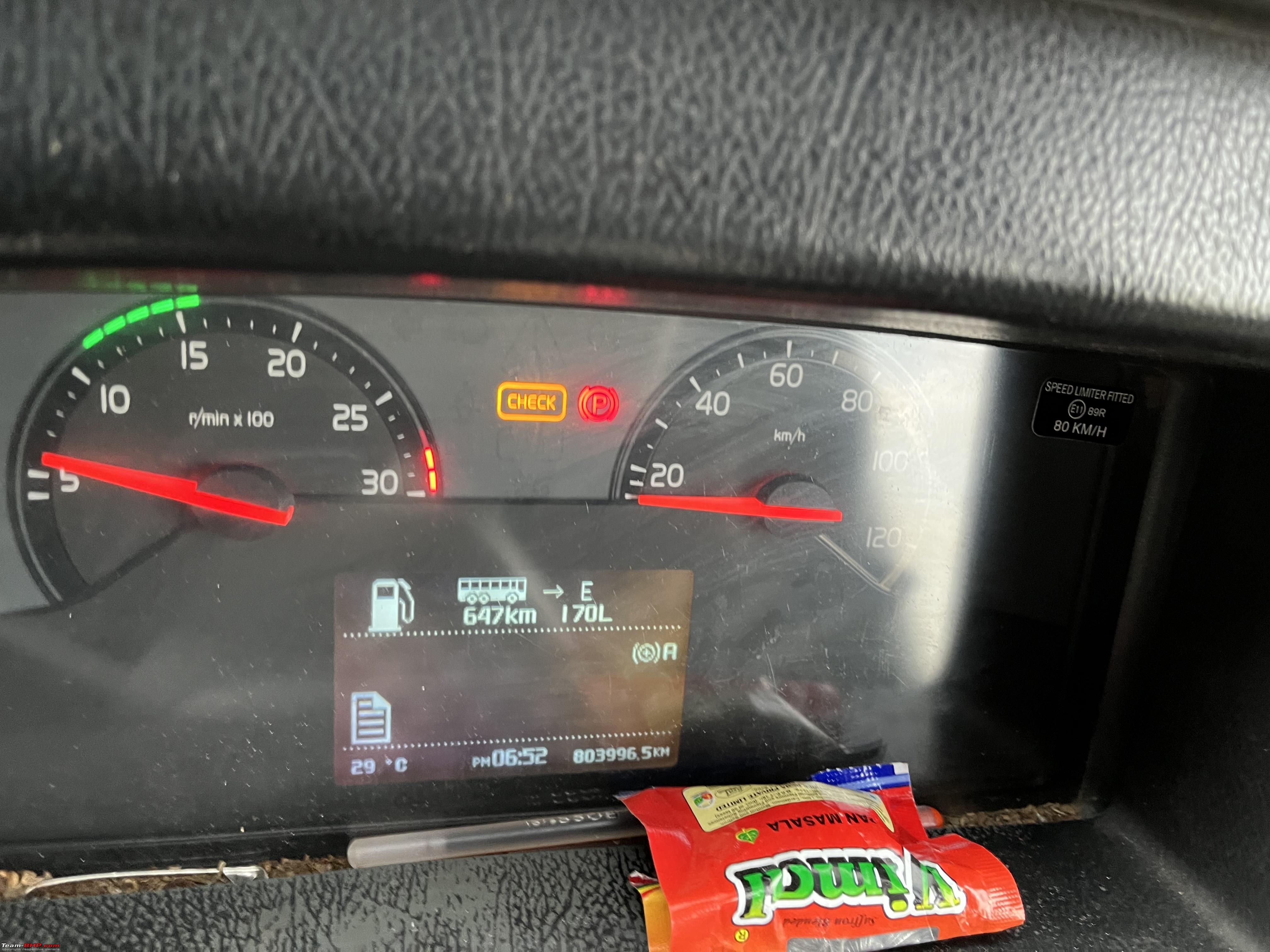

Don’t know about any mass market cars which show actual volume of fuel left, I guess most of them show Distance to Empty(DTE) or Range which would be more helpful to the driver in planning his course of journey and fuel stops to be taken.
However I’ve observed Volvo Buses do show actual volume of fuel left as well as Distance to Empty, I do wish our cars also had a similar system just for the sake of information for those of us who like to crunch numbers
