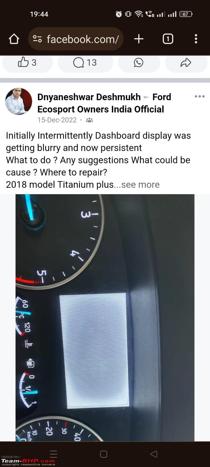

Hi all, I thought I'll share one important piece of info which quite a few ecosport owners have been facing in India of lately pertaining to the 4" MID speedometer.
Posting the rest of the content on his behalf
Hi Team-Bhp,
I am an avid reader of Team-Bhp.I really enjoy reading posts on different aspects of life like finance/investing, life advice, career, travelogues, and of course automobiles on TeamBHp.
I am writing this to you to highlight a peculiar issue with 2018+ facelift models of Ecosport, which has a bigger MID LCD display in top-of-the-line variants. I own an Aug 2018 Ecosport S Diesel, totally stock, with no accessories other than a dashcam powered via USB port. The warranty is over. The issue is that the MID screen goes blank/white all of a sudden one fine day anytime the vehicle crosses 4-6 years of age irrespective of kms covered. The rest of the instrument cluster—speedometer, rpm meter, fuel, and temperature gauge—works fine. A lot of customers are facing this exact same issue (reported in the Ecosport Owners Group on Facebook) once the vehicle is turning 4-6 years of age, and since now only the vehicles are crossing this age, such issues are getting reported by owners. I am surprised to see no owner has reported this on Teambhp though. One more issue that is getting reported by many owners is the failure of the Sync3 screen. However that is due to the LVDS cable and that can be resolved easily. Fortunately, I haven't faced that issue yet, but seeing how things are, I fear it can happen anytime.
Anyway, coming back to the issue, when reported to FASS, the only solution available as of now is to replace the entire instrument cluster, which costs a lot—INR 28k+. There are no child parts available. When I escalated this to Ford India Customer Care, my vehicle was kept for diagnosis with the Ford Technical Team for 5 days at FASS. FASS SA mentioned that they shared pictures, battery reports, etc. with the Technical Team. He also mentioned when another instrument cluster was connected, it was working fine, so there are no issues with wiring, etc. So later, as expected, the technical team has come up with a silly excuse blaming the non-Ford battery (Amaron). They are just trying to wash their hands off the issue. This is clearly a case of a substandard or low-quality product that is failing anytime in 4-6 years of age for multiple customers. Also, while searching online, I see that Ford clusters for other international models also have this issue; YouTube has many such videos where they replace just the LCD part. LCD is available on aliexpress however the customs costs does nit justify the part of pricing for the LCD if we import it individually. That part is not available here in India. Also, replacing the entire instrument cluster is not a viable option, firstly because it's too costly, and secondly since the same part is bound to fail again anytime in the next 4-6 years and the cycle continues.
I wish to know what our options are.
Can this be escalated further? Can higher-management folks from Ford India be involved in this?
Can we hope that Ford India owns up to this issue and does a recall or replaces the faulty part under goodwill?
Is it really fine/expected for electrical parts to fail within 5 years? I don't think electrical parts should fail so early. It's neither a wear-and-tear part nor consumable. Such LCD displays have been in use since 2010's in vehicles, and I don't think such an issue is reported in any other brand this early that too for so many customers at the same time or gather all such owners and file a case in the National Consumer Forum since their technical team is trying to wash off their hands, giving silly excuses?
Any other options?
This issue is similar to the Ford wheel lug nut case, where the product design itself is faulty, which is bound to fail after a few years, and then the customer is asked to replace it again with the same bolts. Those bolts were also costing a bomb; thankfully, there are aftermarket options available. But in the case of instrument clusters, there are no aftermarket options. Looking forward to your invaluable suggestions and opinions.
Thanks,
Firoz
Attaching a couple of pics from the OP
I believe this is a serious issue and Ford needs to address this issue which is feasible for both the OEM and the customer. There have been more than 500+ complaints across multiple Facebook groups on the same issue and there needs to be a viable solution.

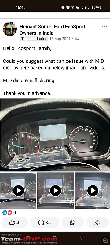

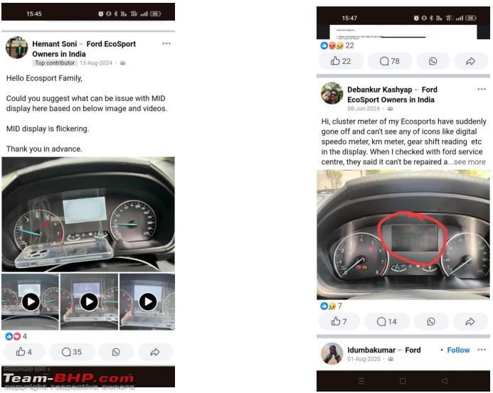

Thanks to Firoz Khan for sending this information in. Heartfelt gratitude for sharing it with other enthusiasts via this Team-BHP share page!
Hi Team-BHP,
I have attached screenshots of multiple owners reporting the same issue in various EcoSport Owners Facebook Groups for your reference.
Issue: Multiple owners of EcoSport 2018+ models with the 4-inch MID are facing the same issue as early as 2-3 years and mostly around 4-6 years of vehicle purchase. This seems entirely due to the sub-standard quality of the LCD display and Ford India seems to be well aware of it, but is not acknowledging the issue. The details of this issue have already been posted by one of your members, Jithin on my request, but I would request you to move the post to the home page for better visibility.
Further, I see someone has commented on the Team-BHP thread that it could be because of the non-OEM battery and it's not a widespread issue. That is not correct.
1. I am using an OEM spec battery, just that the brand is different.
2. There are multiple owners having Ford batteries themselves, but are still facing the same issue. Ford India is just ignoring them.
3. There are also a few other owners who are using non-OEM batteries who haven't had this issue. So, it's clearly not because of the non-OEM battery.
4. Then, there are multiple people who have had this issue within 2-5 years and Ford India is quietly replacing them under standard warranty. Hence, there is not much noise online.
5. Also, majority of the sales of the EcoSport or cars of any other brand are for mid-variants. Those variants have a smaller LCD MID, which does not have the same issue. Since now only the higher variants of the 2018-2019 models are crossing the age of 4-5 years, such issues are getting reported online.
I really hope that you post this issue on your respected home page so that Ford India acknowledges the issue and do something about this.
