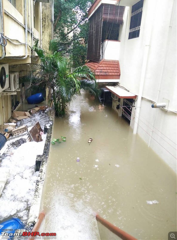

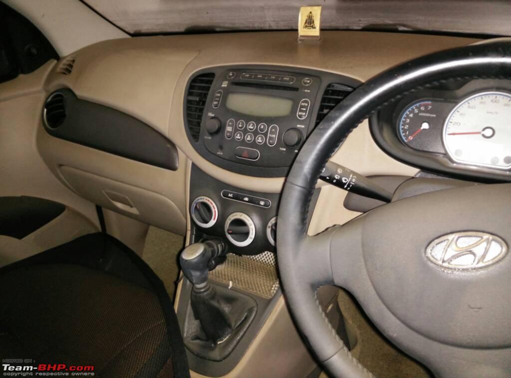

The pics will do the talking. Water entered the car till the rooflines. I had closed the exhaust and the air intake, but stupidly forgot to remove the battery terminals. The driver side power had opened automatically and headlights and blinkers were flashing away till battery was dead.
Is that so, this was to be a safety feature added after the 2005 Mumbai floods, where many people trapped in their cars could not open doors after car was submerged, and suffocated to death.

Yes. It happens during shortening of circuit where battery is still pumping energy. Infact the alarm system is the first to give way and then the internal circuits. The only option is to get the battery disconnected and stored away from car and rest of things will work after car is bone dried.
