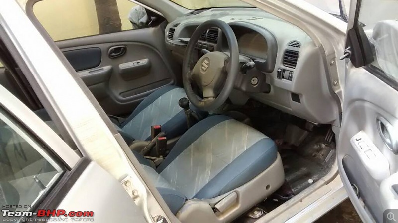

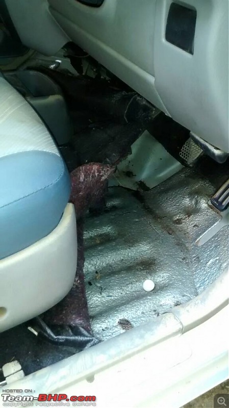

Was almost inclined to go the FNG route. Wanted to give MASS one last try, so called the regional service manager and spoke for a good ten minutes. He talked calmly and reassured that Maruti will be replacing all critical submerged parts, and that for an Alto K10 with an IDV of 2.35 lacs, it will not go for a total loss, and will be repairable only.
MSM called me yesterday and said they'll come over to my residence to inspect the vehicle and complete the initial documentation. Will get an estimate in 4 days, post which they'll tow. Estimated time for repair is around 4 weeks, but I'm preparing myself for two months.
In the meanwhile, I've removed the seat covers, opened up the carpets at the edges, sponged away as much of water as possible. Now just hoping I can avoid as much corrosion as possible, in case I never have a chance at getting a total loss settlement. We also need to remind ourselves that this is India. Period.
Maruti will bear 50% of that amount which insurance considers as depreciation for parts. Hoping the financial impact to me is contained within 30-40k.
I'm getting a slight positive vibe from all these recent interactions. Just getting follow up calls from MASS itself is reassuring, and they're attending to my car basis a waiting list which we had filled out on December 8th.
I had also written them an email similar to the one someone here wrote to another manufacturer, about transporting cars to other towns for servicing. I got a response thanking me for the feedback, and asking for details of my car and contact.
Just hoping for the best!
Peace.
Abhishek.
