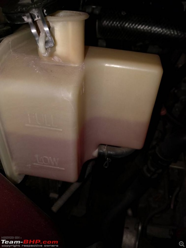

Please check the first picture showing inside of the radiator cap and comment if it's in acceptable level.
Secondly, please check the reservoir tank. It was 2/3 centimetres above the FULL mark since I bought the car 8 months back until last week but now it's below that mark. I've found that my newly appointed driver kept that cap of reservoir tank open. He's saying he did it unintentionally. But is this the reason why the coolant level has decreased?

I think there is nothing you need to worry about. As per pictures, all is fine and there is no topup required for now.

Start to worry only if the coolant level reaches near the low mark, Till then just keep a regular check on the level now so that you don't come to know about it when its a little late.

Nahid, the reservoir tank is actually overflow tank for the coolant in the radiator.
One of the major constituents of the coolant is a chemical called Ethylene Glycol that expands when exposed to heat. In fact when the car`s engine is cold the reservoir should always be lower than the full mark as it would need space for expansion when the engine is running.
Also you do not need to open the radiator cap to check the coolant level; you only need to look at the level in the overflow reservoir & looking at the picture the level is quite alright.
I don`t understand why your driver is fiddling with the reservoir cap as the coolant refresh cycle of current generation cars will be upwards of 1,00,000 kms. In any case you cannot put any tap water in the coolant as has already been mentioned by other contributors.
If the level in the coolant reservoir drops drastically over a few days that can be indicative of something serious & that needs to be looked at by your neighbourhood Toyota dealer however in view of the fact that your car is almost brand new that is quite unlikely. As you have mentioned the level has gone down over a period of eight months & it is normal in view of elevated temperatures & thereby some amount of loss due to evaporation.

Thank you all for your feedback. The drivers have a tendency to pour water on the radiator cap on regular basis may be because the learnt driving on cars which are ages old. I've seen this tendency on all of my previous drivers. I had to educate them.

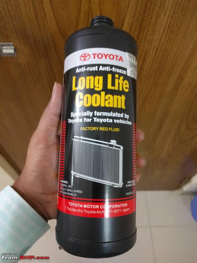

Btw, I bought this coolant to use just in case I need it. It has no mentioning that it's premixed so I guess I need to add water on 50/50 ratio. Is bottled drinking water fine or should i use distilled water?

Please read the instructions on the label. If it recommends mixing with water then use distilled water. If DW is not available use clean drinking water. The ratio will also be mentioned. It is normally 50/50.
The premixed coolant is pink in colour.
Also please reiterate to your drivers to NEVER keep the expansion bottle cap open (it affects proper function of the cooling system) & never pour plain water in either the bottle or radiator.
I mixed this antifreeze with distilled water at 50:50 ratio. Unexpectedly the mixture got a little bit hot. Not extreme hot but it can be felt on hand easily. Though neither the coolant nor the distilled water was hot. I'm a bit scared. Though it's cooling down eventually but should it happen?
PS: I bought the distilled water from a local car parts shop. It's labeled 'battery water' but still it's distilled water.
