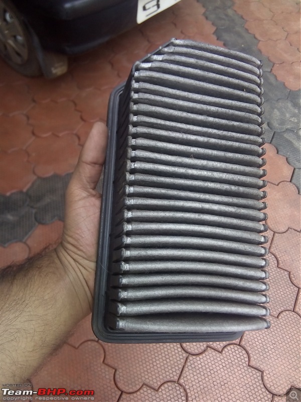

Took my smokey to a Local workshop here at my place. The garage was full and so he took a quick look at my air filter and asked me to change it since it was already due. Posting some pics of it here. I was said it was good enough for an easy 2k kilometers by the SA
