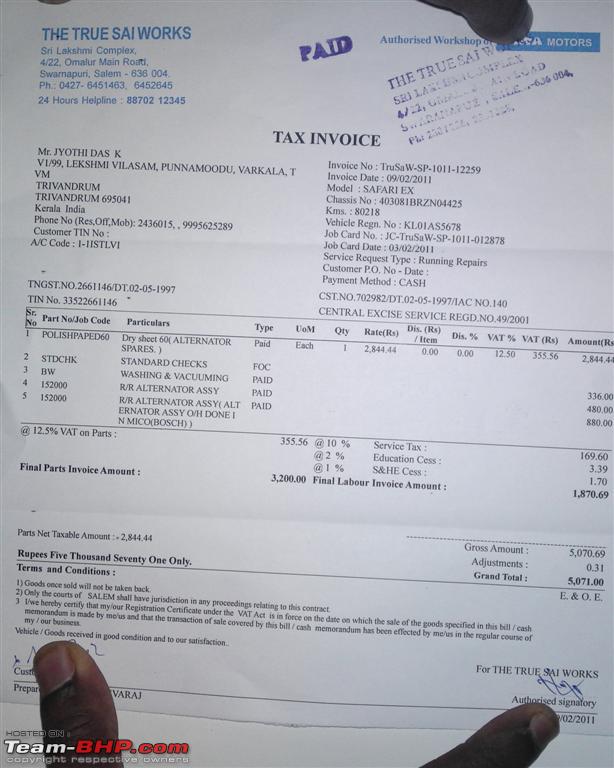

Tata Safari 2.2L ; alternator issue
Thanks guys
What they intend to do is take the alternator out and give to TVS/Bosch to check and change only the relevant part.
Will keep you all updated.
The TASS gave the alternator to TVS for servicing. Cost me 5100RS in total.
The Tata Safari 2.2L Technical / Problems Thread-09022011569002-large.jpg

Re: Tata Safari 2.2L ; alternator issue
What spares were replaced? The labour seems to be on the higher side as well.
