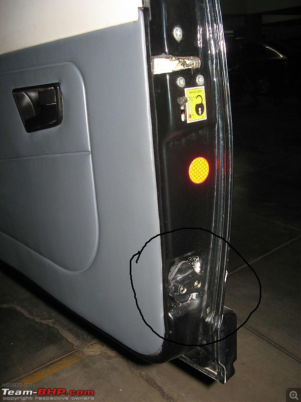

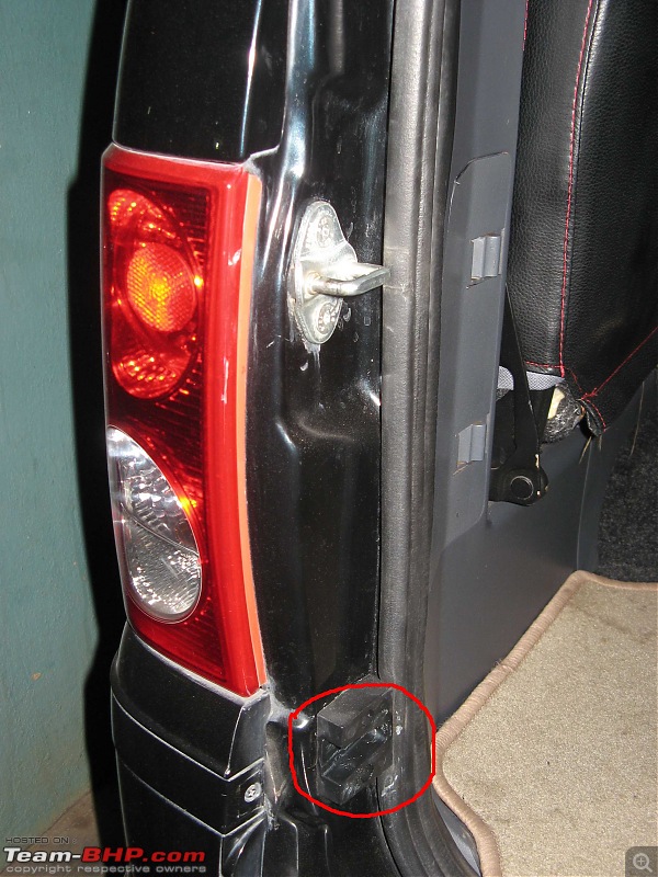

Here are the pictures of new Dove tail joint , The rattle has not reappeared in last 4 days. Quoting the parts list again for convenience
Originally Posted by amitk26 (Post 1427886)
S.No Part No. description Rate
1. 269974306316 Rubber Stopper T.G 16.00 X 3
2. 289581306301 DRG. Dove Tail Body side 56.00 X 1
3. 289581306302 DRG. Dove Tail - Tailgate side 56.00 X1
4. FST001 Bolt 4.44 X4
5. FST 002 Washer 1.78 X4
6 FST001 Bolt 4.44 X4
The last 3 item means 4 bolts matching the body side dovetail joint and 4 bolts for door side and 4 washers.
Total material cost with VAT is 202. 67 Rs and Labor charges were 450 Rs.
The Tata Safari 2.2L Technical / Problems Thread-dova_tail_ds.jpg
The Tata Safari 2.2L Technical / Problems Thread-dove_tail1.jpg
The Tata Safari 2.2L Technical / Problems Thread-dove_tail1_bs.jpg
The Tata Safari 2.2L Technical / Problems Thread-dove_tail_bs.jpg
@ amitk26: good to see that tata has done something to cure the rattling, which is now almost a standard feature in the safari. by the way, the work done appears to be very shoddy.
The Rattle in my safari was a single big squeak of tail gate on those foot high humps so common on our roads. The cabin is silent now both on roads and off road on gravel track ( not 4X4 kind)
I think shoddiness you see is just a lot of white grease which will go away in a week or so the job looks OK to me at least not any more shoddier then what was in OEM because it is just a bolt on job and can be done as DIY.
The 450 Rs is just for the sake of A.S.S to suggest the right parts and telling that it can be done done ( Consultancy fee :D )

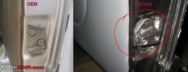

3. 289581306302 DRG. Dve Tail - Tailgate side 56.00 X1
Thanks, here's the comparison.
The Tata Safari 2.2L Technical / Problems Thread-body.jpg
The Tata Safari 2.2L Technical / Problems Thread-door.jpg
