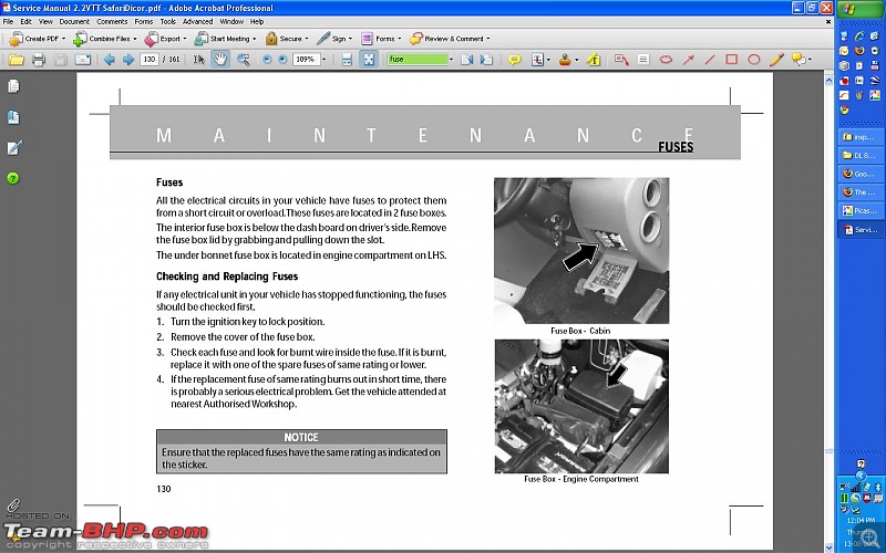

Where are the fuses for the 12V power sockets located? Any idea?

TSK,
Did you check the fuse box right next to the steering? (right side). There is a flap, which opens up to show the area that houses a lot of fuses. The layout diagram is present on the flap. My guess is that it should be there (and there are a lot of them there!!!).
Originally Posted by HappyWheels View Post
TSK,
Here's the scanned copy of the location of the cabin's fuse box location (from the manual)
