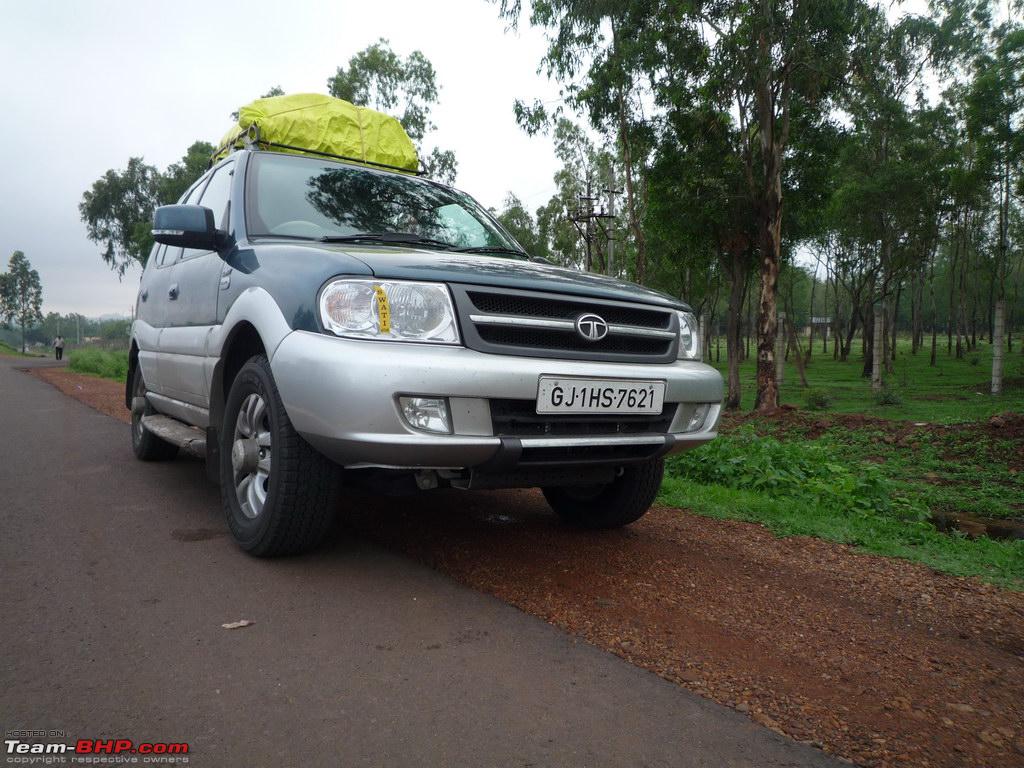

Finally a solution to the wind noise inside the safari
Well a lot has been written about the wind noise (from the left front window), which is practically a howl at speeds over 60Kms an hour and apparently a lot of us have tried quite a few things to reduce the noise. This problem seems to be there in all the vehicles (the GX included)
Now finally a sure shot solution with actually works !
The Tata Safari 2.2L Technical / Problems Thread-p1010796.jpg
Thats right you are actually looking at it ! With the lugguage rack, attach to the roof rails and bags piled on top, okay i even had a plastic sheet covering the bags, the wind noise was practically non-existant.
I drove the Safari upto a little over 140 kms and there was no howl. Apparently that ugly contraption (which i will be removing over the weekend) causes enough wind turbulance around the front window and stops the noise.
Some people may feel its better to bear with the noise rather than carry all the luggage like shown in the pic, but since I had no choice, it turned out to be a blessing in disguise.
Any thoughts ?

@Umang:
Do you mean to say that, having one of those luggage carriers (the kind that you will see in that Airport Innova's, as shown here ( Airlift - Luxury innova car to BIAL (Rs 300/- only anywhere from Bangalore). )?

Old 14th July 2009, 08:00   #900
umang dutt's Avatar
Location: Ahmedabad
Posts: 108
Thanked: 99 Times
Originally Posted by HappyWheels View Post
@Umang:
Do you think that will work? It will be a better option and this, mmm...., DIY.
Hmm, I am not sure if the carrier by itself will work, atleast mine did not. I mean the bags on the top made the difference. The noise was very much there without any bags on top.
However with all that cladding on the carrier (image in your link), it may be worth a try. If it causes enough turbulance around the left window it may just do the trick.
