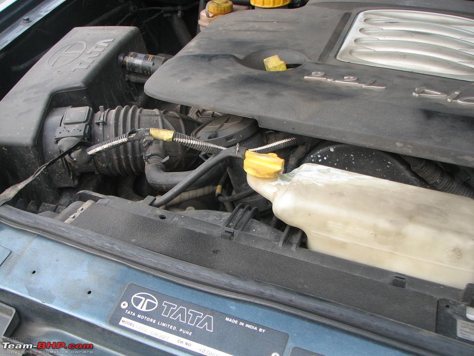

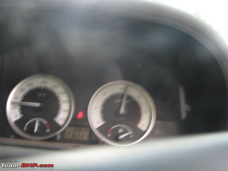

Need urgent advice!!
Right now we are in the midst of a very strenous journey necessitating the VTT to travel in high stress conditions through bad and very steep roads. This is the last internet connection that I got through Airtel datamodem and as such posting.
The very steep road, with a fully loaded Safari, had the VTT travel at high rpm and 1st gear only for around 45 mts to 1 hour. Around 3-4 places, standing starts on steep roads had to be done as there was not enough place to take the u-turn at one go and needed around 2-3 back and front movement and thus around 2-3 clutch burns happened though briefly.
The Tata Safari 2.2L Technical / Problems Thread-img_3256.jpg
How will the life of the clutch hold for the remaining part of the journey like another 3 days in similar roads and if with similar clutch burns? Any stranding and it will take around 10-12 days just to salvage the VTT from these places.
As I opened the bonnet after reaching this place, saw that the coolant overflowed - please see the white marks. Is this normal? Of course the engine was under extreme stress due to 1st gear travel at high rpm to maintain momentum and stalling.
The Tata Safari 2.2L Technical / Problems Thread-img_3263.jpg
Please also see the coolant mark? It is just above the second line and there is another line down, so there is enough coolant?
The Tata Safari 2.2L Technical / Problems Thread-img_3265.jpg

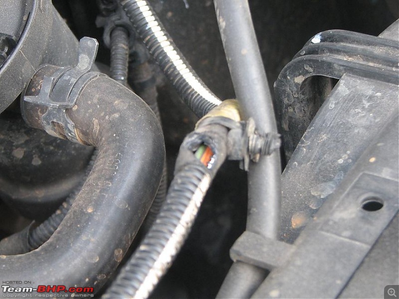

Also very, very fortunate that I opened the bonnet, the very jarring ride had make that wire that comes out from the filter and turbo charger to become loose and it had come in contact with the fan - very very lucky that it cut through the enclosed wire casing but did not cut through the wire. Have secured it very securely now. Very very lucky!! as any stranding here will take around 7-10 days to extract the VTT and we go to more remote areas now.
The Tata Safari 2.2L Technical / Problems Thread-img_3264.jpg
The Tata Safari 2.2L Technical / Problems Thread-img_3266.jpg
Not to worry, it not uncommon for a 2tonner to have some mild clutch slippages upon steep ascents from standstill. Unless, the clutch smokes (literally), in which case you will need a new clutch but I have seen smoking clutches also working for many miles before giving up.
Coolant marks are also normal, I have seen them in my safari too, upon long straight drives.
Saw the picture you posted but dont know if at that time the Safari had just run in or was cold. The coolant should be at middle mark when cold (standing overnight). If you can see the coolant at the same level when cold, you need to fillup till the middle line.
It seems that the clamp has come off, I can see the plastic clamp still attached just near the casing tear. Its a good practice to check at the end of the days drive or in the morning next day for such problems during a streneous drive, everyday.

adc, from the pics it appears that coolant leaked through overflow tank, which is fine, sometimes it may happen.
However just to be double sure, open the radiator cap(when cold) and check if its full. Radiator has majority of the coolant in case of the safari.
As for clutch burn, you cannot avoid it in steep hill starts, but keep it to a minimum. If you anticipate a sharp turn, take a wider line as buses do, and maintain speed.
tsk1979 is offline
Old 3rd June 2009, 17:18   #823
adc
adc's Avatar
Join Date: Mar 2007
Posts: 1,352
Thanked: 2,315 Times
Thanks much!!
Thanks a lot dadu and tsk - so net-net everything is normal right now. Opened the radiator cap and saw it full. The clutch then is okay and should be okay for quite a long time - and thats good news. The journey gets much rougher now and again is very lucky not to have cut the wire though the casing was gone as it was touching the fan.
So all you guys do make sure that bunch of wires remains clamped and secured as once free it tends to go towards the fan. Made it double secured by taping it myself and also clamping it.
Thanks a lot again!!
