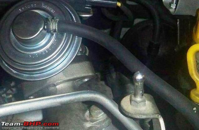

Most issues solved.
Originally Posted by Rahulk76
I had a few issues with the vehicle mainly engine jerking and hesitating in 1500 to 2000 rpm band. The following codes were seen during the first service
TASC didnt have a clue about it so they escalated to TML. Now wait starts
1. P0245 - VGT DRIVE SHOT TO GROUND.
2. PO489 - EGR SOLENOID CONTROL
3. Brake pulling towards left.
Except point no.3 the above 2 points were not present when vehicle was inspected by CS TML.
They arent very sure of whats the issue even after bleeding the brake system and changing the brake pads.. so now its only brake discs in question left.Having said that, can anyone shed more light on this issue and possible cause ?
Most importantly, the vehicle jerk and hesitation were due to a minute hairline crack in the black tube which connects to the egr valve.( quoting from the pic posted below from http://www.team-bhp.com/forum/techni...ml#post1161065)
