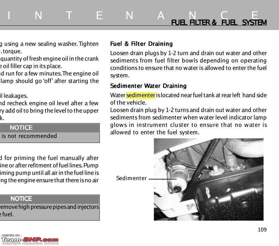

Suman, we do a lot of remote places, where finding a TASC is not an option. Thats why I was asking that will doing this myself VOID warranty or something?
The only tough part seems to be removing the skid plates, which are bolted on very tight.

You dont have to remove the skid plates for this, its on the left of the fuel tank if you are facing the rear door. To get more visibility remove the tow-hook cover from the rear bumper and look to the left through it.

Ok Dadu, got it from the manual, thanks, this is an easy job
The Tata Safari 2.2L Technical / Problems Thread-1.jpg

Just for info, in case someone looking for it cannot find it:
Older 3.0s like mine have the same sedimenter located in the engine bay, accessible through a small gap in the right right wheel-well. Later 3.0s had the sedimenter fitted in the position shown in the picture of the 2.2 manual as put up by tsk - behind the rear bumper, next to the fuel tank.
