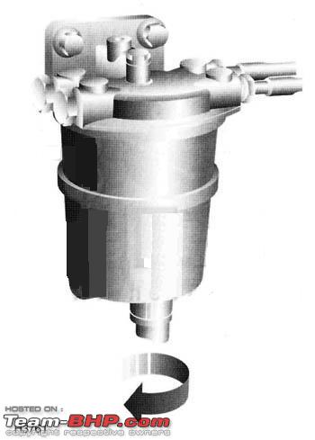

You drain the water by unscrewing the drain plug.
The Tata Safari 2.2L Technical / Problems Thread-041a.jpg
(not an exact representation for Safari, for illustration only)
To drain: Slacken off the drain plug, to allow any water to drain off. Retighten the plug as soon as pure diesel is emitted.
If you dont the engine might start giving you hicups and might die later due to excess water in the fuel. Prolonged water can cause damage to the injectors.
Its a simple DIY, unless you are too scared, then suggest the TASC.
Anyways I had asked this query earlier also, but no reply.
What do you do when the water in sedimenter light comes on?
The owners manual(which i downloaded) suggests that you can loosen a screw, drain water and again tighten the screw.
Is this a simple DIY or you have to go to TASC.
What happens if this light comes on at a remote place. How many kms can you drive without harming the engine or fuel pump etc.,
