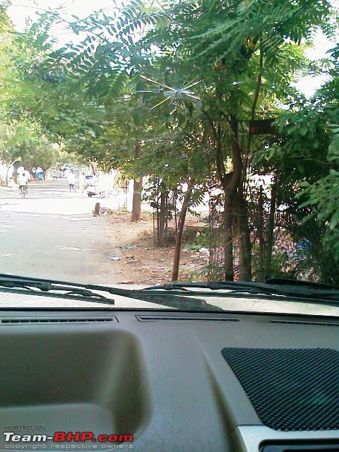

Friends, This happened today morning as i when i driving on the highway. A stone came flying out of nowhere and hit the windshield.
The result is below. Need the following info from you as i never faced windshield issues with any of the cars.
1. Do i need to replace the windshield immediately?
2. How much will replacement cost? Will insurance cover glass?

Bad! Very bad. Must be some rotten & jealous person! Hope that person gets a similar treatment!!!
Coming back to this - yes change the windshield. Totally unsafe like this. For glass I guess you get 50% coverage from insurance.

This is really sad. I too had a similar incident about 6 months. I was on the Delhi Manesar Highway and was following a truck loaded with small pebbles. All off a sudden a stone comes flying, I am not sure whether it was from the load the truck was carrying or from the rear tyres, (sometime stones get caught between them) and my windshield gets a crack just below the passenger side wiper and that too towards the edge. But the damage on my glass was very little compared to yours, and hense I have not got it replaced.
However I inquired from 'Windshield Experts' and after claiming insurance and all, my side of the liability was working out to be approx 1800 bucks, and the mirror, I am not too sure on this front, costs roughly between 10-12k or so.

Guys, I called the TASS (Mallik motors) and enquired about the front windshield. It costs RS 5750. My insurance agent said it would be 50% claimed. Altho not a big amount but the thought of getting my safari under the knife is killing me. :(

@ CHAXY > recently replaced my front windshield from WE 3 weeks ago. Had a similar but bigger crack than yours due to a coconut. Cost 8500 all inclusive. Tass quoted 11500(they are a total ripoff). Front windshield is covered for 100% insurance. You might have to bear the cost of labour & glue. The same beading is used.
The glass gets 100% reimbursement. Labour also would be completely covered. Any rubber parts is covered 50%. Not very sure about the glue. At least Rs 500 for processing and you would lose your NCB.
Windshield Experts are good for this from various reports here.
