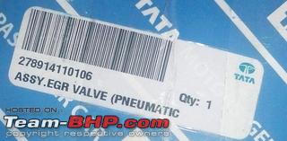

Well why not, btw, the EGR valve in Safari is a pneumatic mechanical one and does not operate at idle.
Are you sure about Pneumatic ?
I thought they are pure mechanical working on pressure difference / vaccuum ?? But then
Yes, proof included with exact part no .
The Tata Safari 2.2L Technical / Problems Thread-2.2legr.jpg
dadu is offline

My bad (and my stupidity also prooved).
Change in pressure / vaccuum is apparantly termed as Pneumatic.
EDIT: back to TSK's issue: EGR is then ruled out and based on TASS Service advisor is anything between the Hub bearing and the front differential (transfer case ??)
