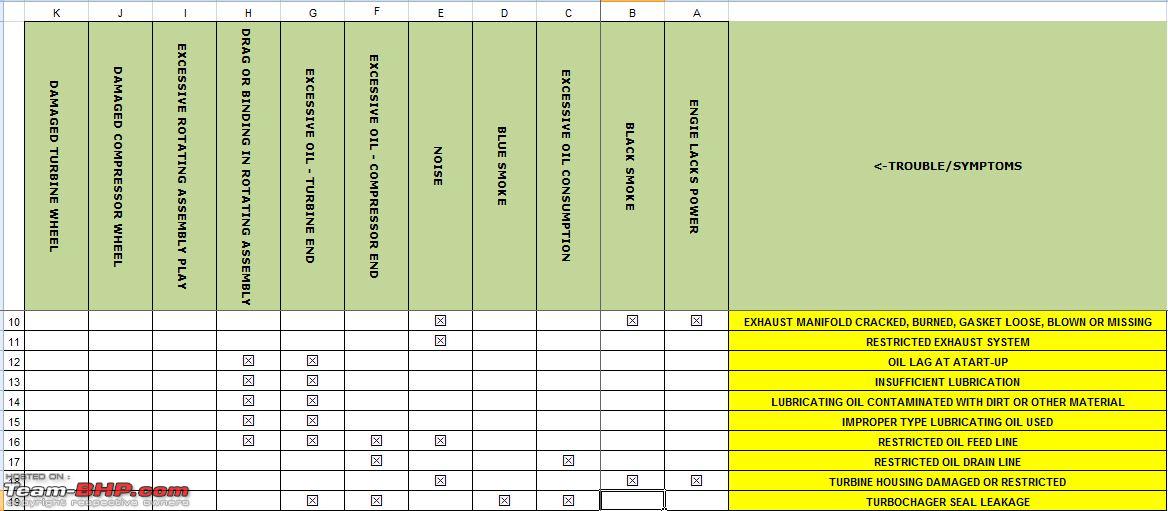

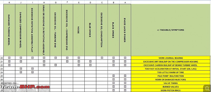

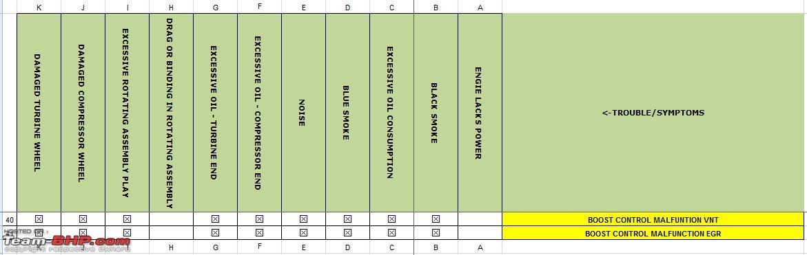

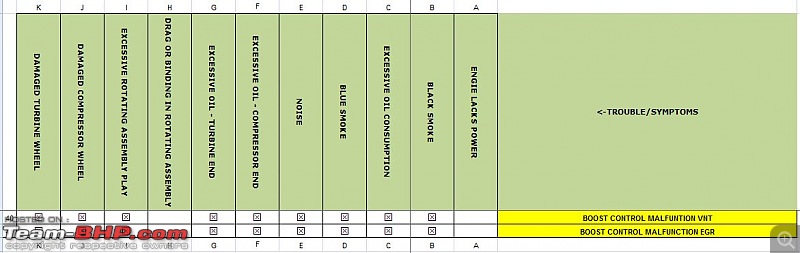

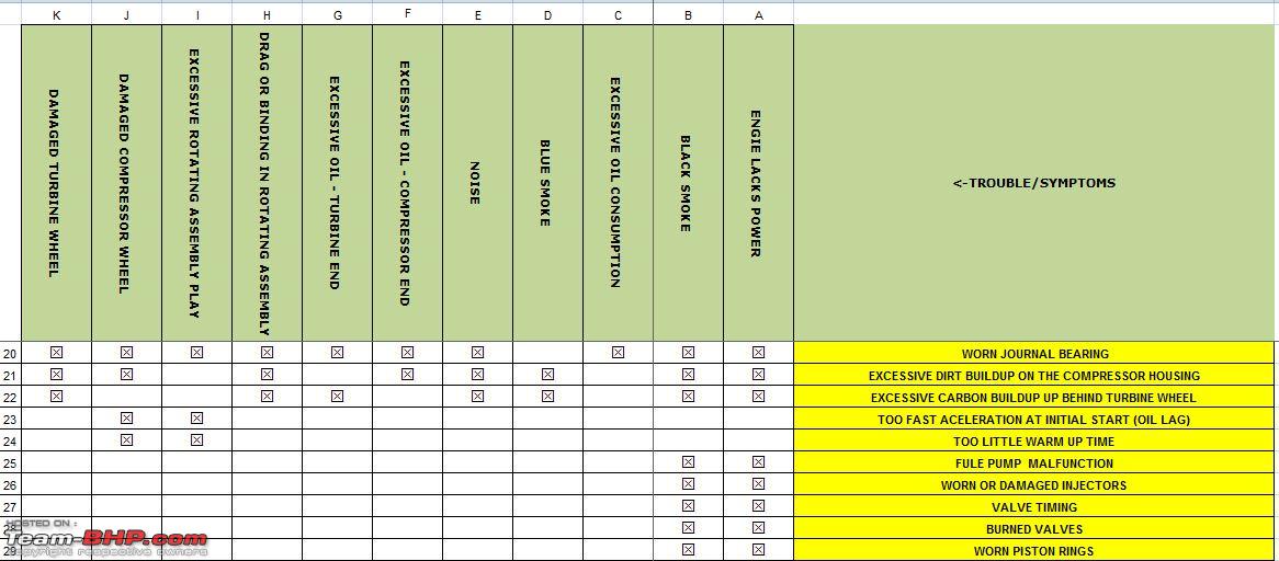

Old 20th July 2009, 23:47   #927
Rahulk76's Avatar
Join Date: Sep 2005
Posts: 1,148
Thanked: 235 Times
Know your 2.2 Troubleshooting -II
Technical Troubleshooting and procedurelal resolutions (From Manual)
DISCLAIMER: This is just given for reference. Your TASC/TASS knows whats best resolution for your 2.2 as the information may vary over time and actual problems may vary on case to case basis.
