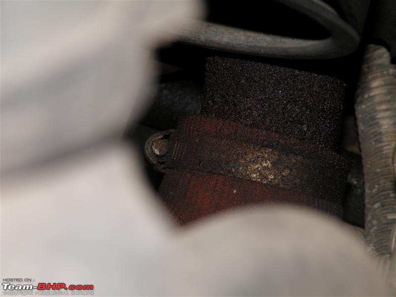

Hi Rahul,
The hose is the small bulged one on the right side (when facing the car) lower part of the car. It is way below the alternator. the pictures may not be so clear due to the location but I hope that you get the idea. This hose will be normally covered in Oil ( I have compared this to other 2.2's also ).
Thanks
Mahesh

Got it Mahesh..Thanks a ton..
Mine is a little misaligned and is squeaky clean. I could also feel it moving left and right though, is that normal?
I could also see the boost pressure sensor on top of that hose.
What does it take to get it aligned properly ? I mean time wise.

Hi Rahul,
The two metal tubes which the rubber hose connect need not be perfectly straight, the rubber if clamped properly seals well.
In any case an easy way to check is to apply some soap water to the joints and then rev the engine couple of times, incase of leaks some froth will show.
Aligning the hose takes on about 5 min, they loosen the clamp and hold both the metal hoses aligned and tighten the clamp.

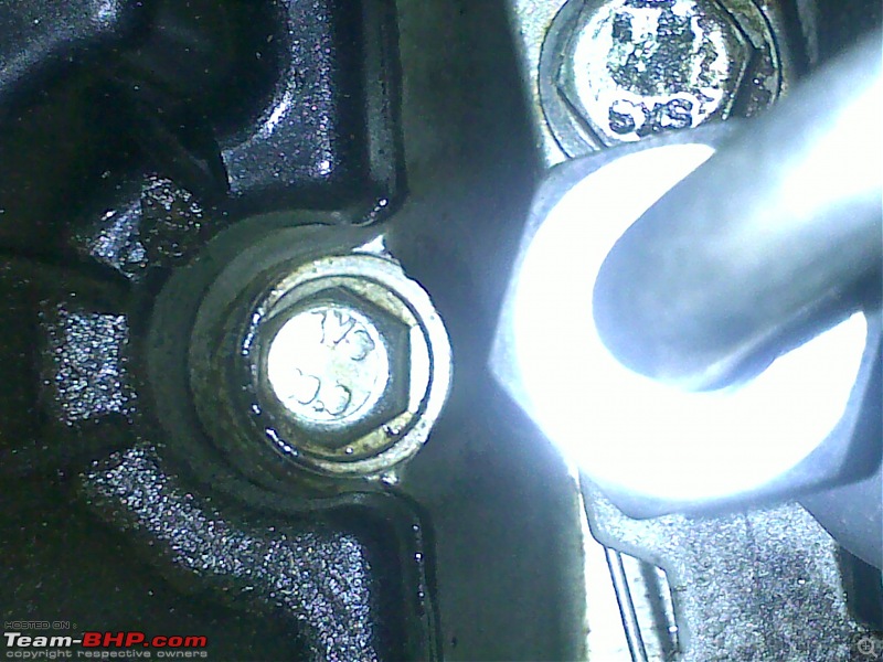

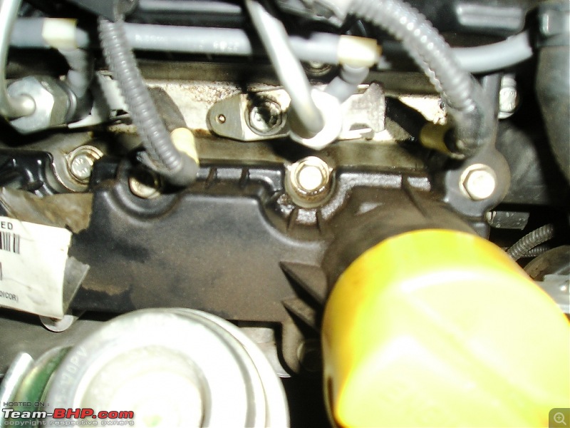

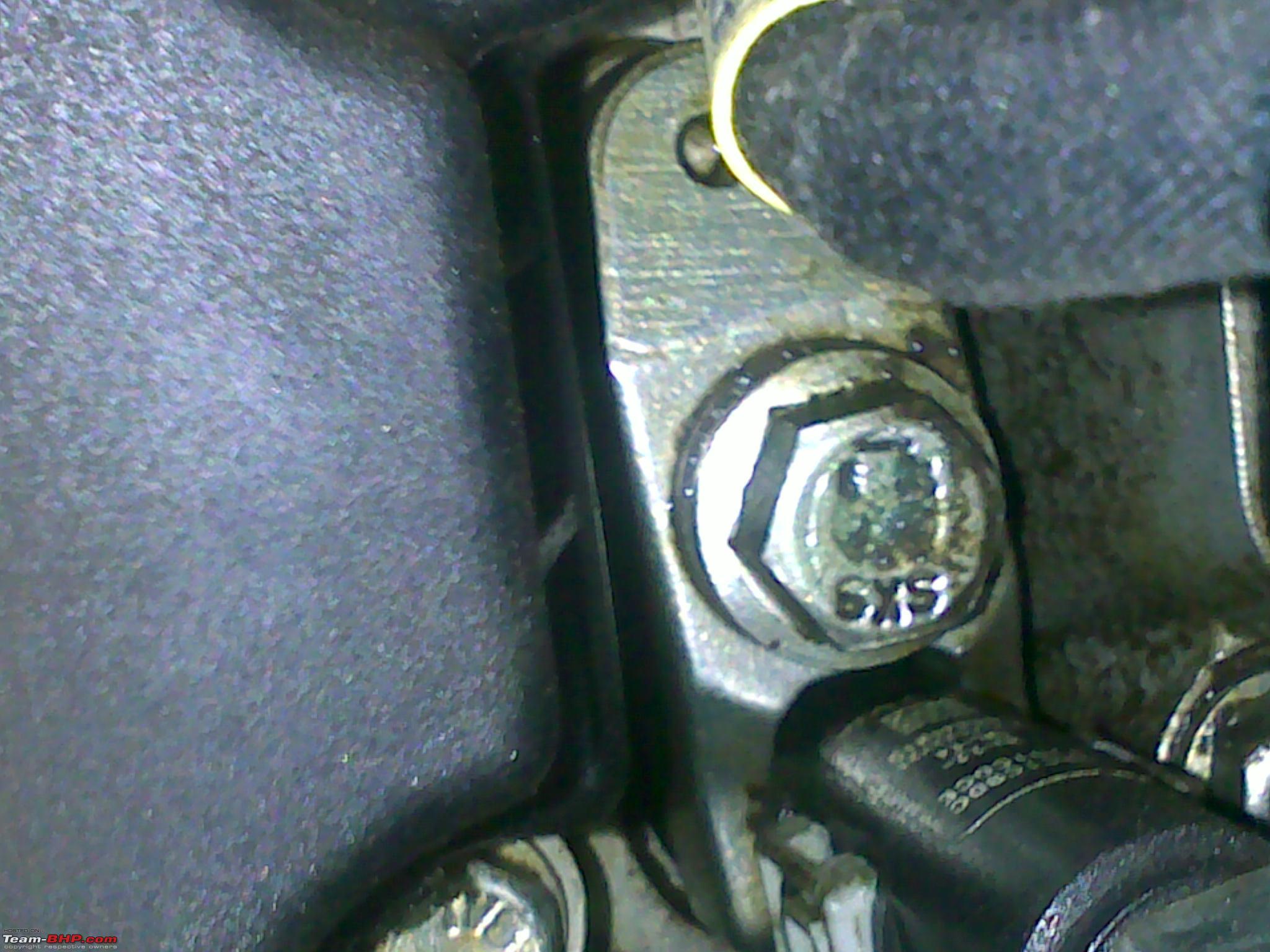

On the other hand.. can someone please point out from the pics below if this is normal diesel leakage or engine oil leakage.
First Pic
The Tata Safari 2.2L Technical / Problems Thread-11122009012.jpg
Second Pic
The Tata Safari 2.2L Technical / Problems Thread-11122009013.jpg
Third Pic
The Tata Safari 2.2L Technical / Problems Thread-p1010017.jpg
Rahulk76 is offline
Old 11th December 2009, 23:46   #1575
bj96's Avatar
Posts: 1,081
Thanked: 1,554 Times
Originally Posted by Rahulk76 View Post
...can someone please point out from the pics below if this is normal diesel leakage or engine oil leakage
arrrg...couldn't make out anything. Looks just like some misty traces of oil- normal at joints carrying pressurized hydrocarbon. Diesel traces will be lighter and non sticky. Oil traces will probably be darker and have affinity to settle dusts. Even high temp lines/spots become tan over time. Sometimes traces of grease or loctite left over on a hot surface will stain yellow.
Looks normal to me for a motor that has run>12k kms. Just wash it off and see how soon it comes back. If 10k kms or so, then it is normal. Looks like you are out ogling every nook and crevice with a microscope
