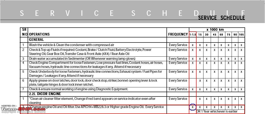

Gurujis,
The Incredible Hulk is due for its first service very soon. So looking for pointers / suggestions.
I was speaking to the Rama Motors SA and he advised that the oil change is not done in the first service, only a top up is done if necessary. I was always under the impression that an oil change is necessary in the first service. I was even looking at the service manual at I see an x next to it.
Another interesting thing I noticed was that Rama Motors Service Center is not listed as a TASS. . Since I got the Hulk from them, should I get the first service done from them or elsewhere in Delhi. Even Autolinks in Vasant Kunj is not listed, though I know it's been there for quite sometime now.
Please suggest.

Regarding the other query, do you guys suggest getting the oil changed since this is the first service.
