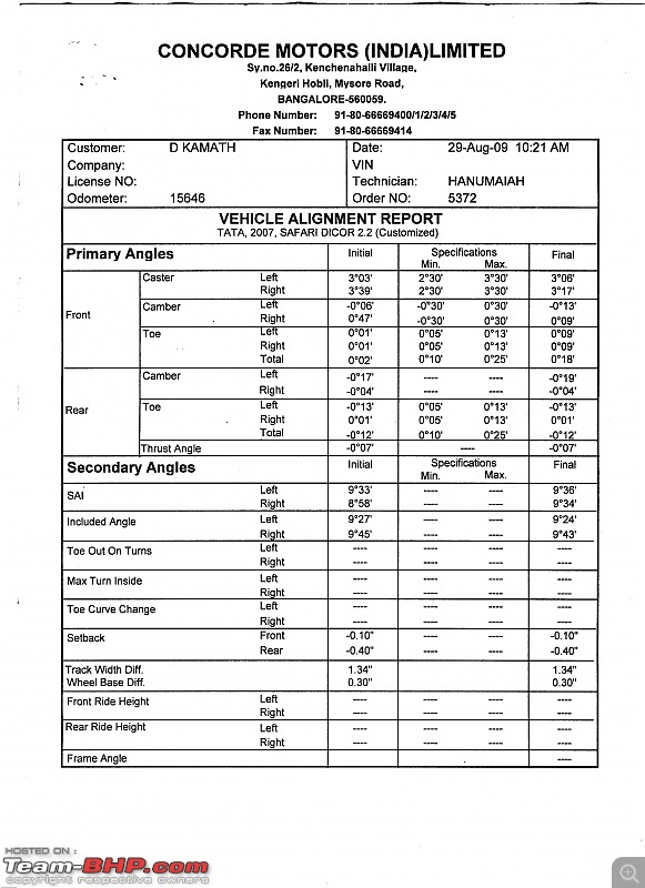

Alignment report
Pinging again .. Can some one please post the normal value range of Camber,Caster and Toe for 2.2 VTT Safari ?
Hi amitk26, hope this helps.
Cheers.
The Tata Safari 2.2L Technical / Problems Thread-alignment_report.jpg
Cheers.
Thanks a ton dkamath for posting this ,
As I suspected the 2.2 Alignment reference values are different from Sumo / Old Safari which wheel alignment shops have.
Safari Owners if you are getting your wheel alignment done take a printout of these values and then get the alignment adjusted.
For Camber, shim adjustment needs to be done which only TASS can do.
T.A.S.S Laser pads for alignment fit only on OEM steel / Alloy wheel so If you have changed the alloys they need to put back steel wheels and do alignment.
PS: Mr. Kamath , I noticed that rear wheel alignment is not done did you enquire T.A.S.S about it ?
Safari is RWD and I think in RWD and 4WD it should be done please correct me if this is not true.
amitk26 is offline
