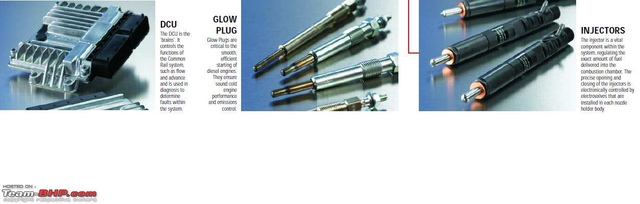

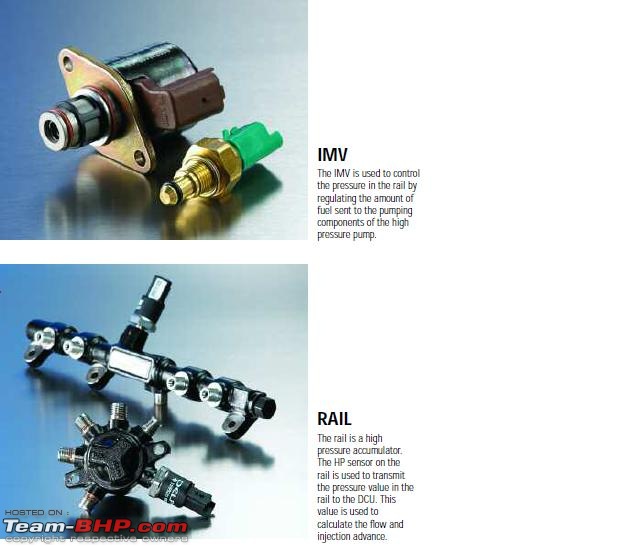

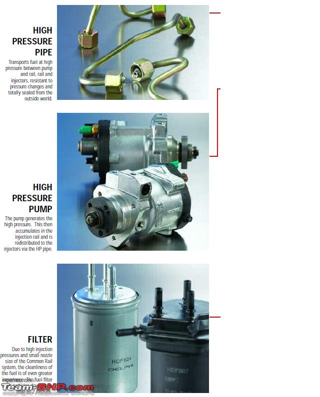

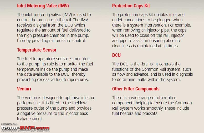

Sample Schematic Layout of Delphi DICOR
Ill let the attached images do the talking

Rahulk76,
Thanks for sharing the Delphi Dicor Sample Schematic layout. This definitely helps me in understanding the technicalities a bit more for the Dicor.
Rideon.
