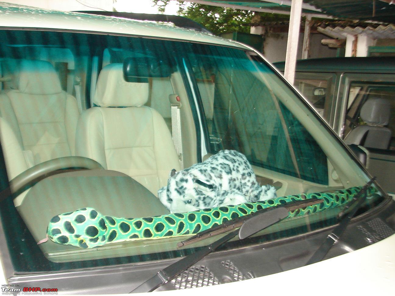

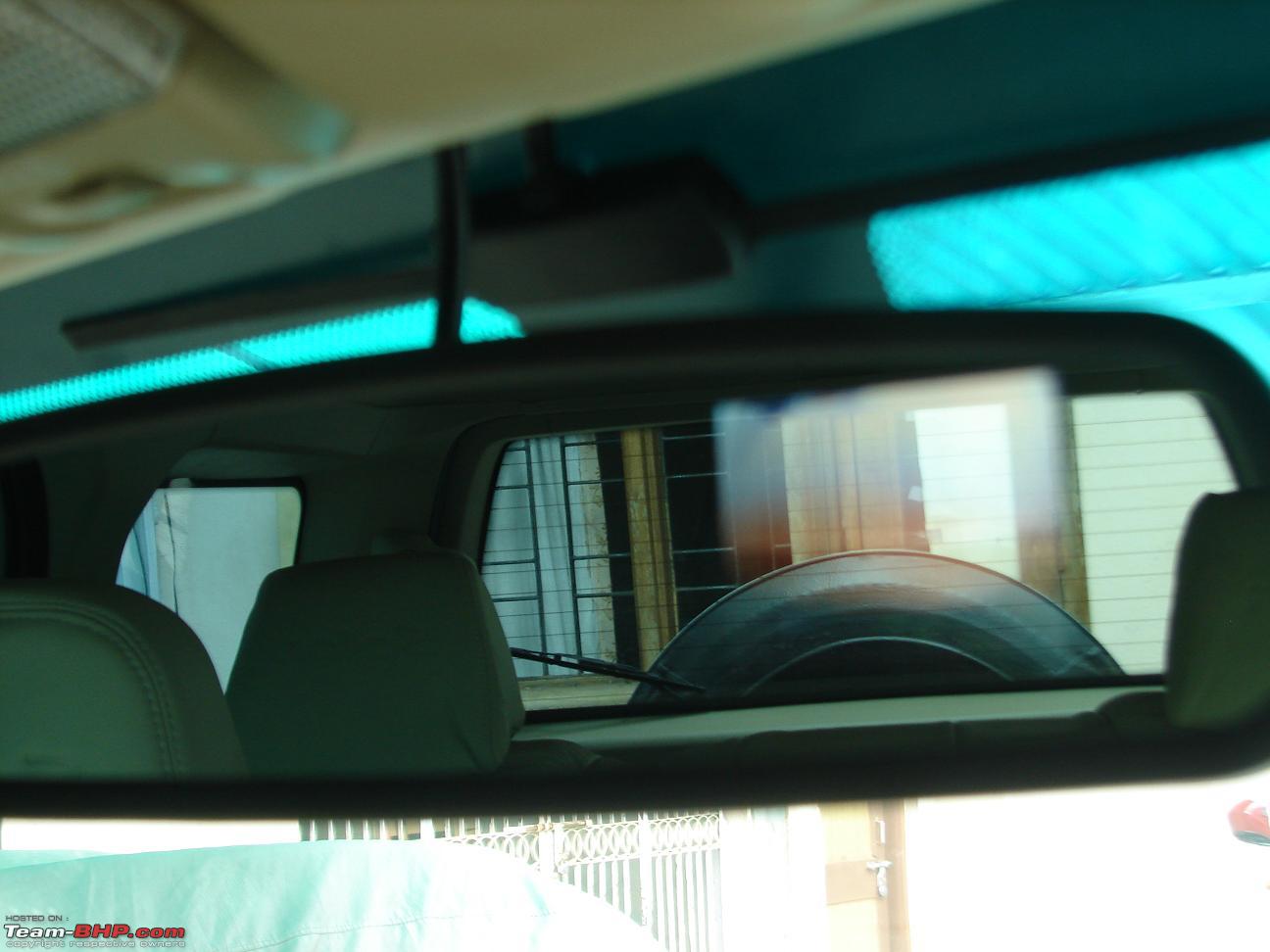

Originally Posted by bj96 View Post
Thanks condor for the schema.
Yes, I checked again and I am missing this lever on my IRVM. I tried to look around my parking for other Tata cars and could only fine few Indicas and Indigos. None of these had this lever... looks like I will have to reach TASS soon .
-BJ
The VX does not have anti glare IRVM's due to the reverse LCD. Wonder whether its the same for the GX.
It used to be a real bother in the beginning, but became better after I installed sun film on all windows and rear windscreen.
The Tata Safari 2.2L Technical / Problems Thread-dsc00674.jpg
The Tata Safari 2.2L Technical / Problems Thread-dsc00635.jpg
Thanks Sid. It alleviates a great agony. All this while i was thinking about another PDI "missing" thingy. However as this is mentioned in user manual they should look at it and fix either the manual or the IRVM. Another point in my next email @ TML
Agree- do not feel the need due to Llumar tint.
OT: Wondering if that giant python not blocking your defogging vents on windshield?
-BJ
-BJ
Glad I was of some help.
The giant python apart from scaring others scares the mist away.
I have kept it a little away from the windscreen.
I agree TML should develop seperate user manuals for different models in a smart way so as to save costs.
