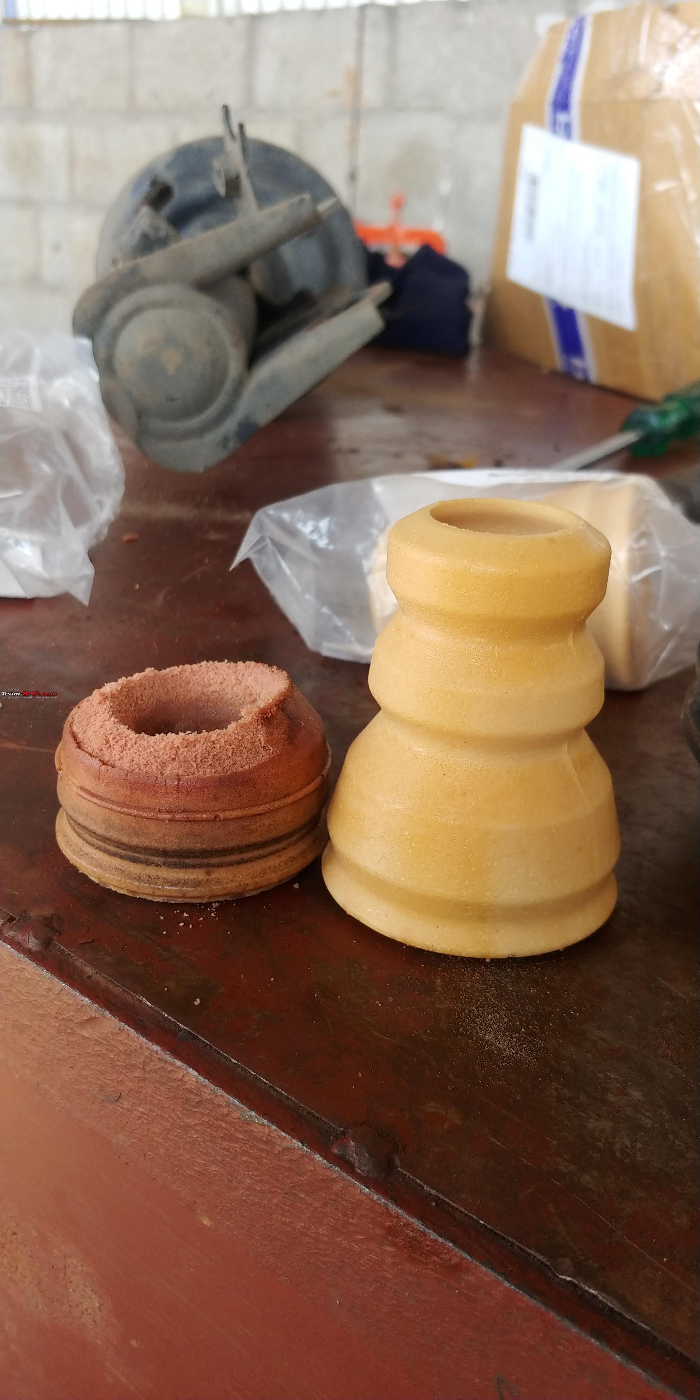

I'll just list the components that were introduced into the assembly,
1. Front struts and rear dampers - Make: TRW
2. Front strut bearings, strut mounts and bump stops - Make: Honda
3. Front stabilizer links, tie rod ends and ball joints - Make: TRW
4. Lower control arm bushes and front stabilizer arm bushes - Make: Honda
Honda Civic : Maintenance, Service Costs and Must dos-20220413_105231.jpg
Honda Civic : Maintenance, Service Costs and Must dos-20220413_100254.jpgHonda Civic : Maintenance, Service Costs and Must dos-20220420_113803.jpgHonda Civic : Maintenance, Service Costs and Must dos-20220420_125034.jpgHonda Civic : Maintenance, Service Costs and Must dos-20220413_143604.jpg
Only during the disassembly of the struts from the spring, I discovered the bump stops were perished, left strut bearing was disintegrated and the struts rods had no rebound when subjected to load! Since my car treads only on smooth highways, the non-functioning of these components weren't so evident earlier. Thereby, I strongly insist every civic owner to check the condition of the strut assembly.
The OEM LCA bushes are manufactured in Japan and have ovality, meaning they are not exactly circular. This ovality helps in having a strong interference fit in the hole-shaft assembly, IMHO.
