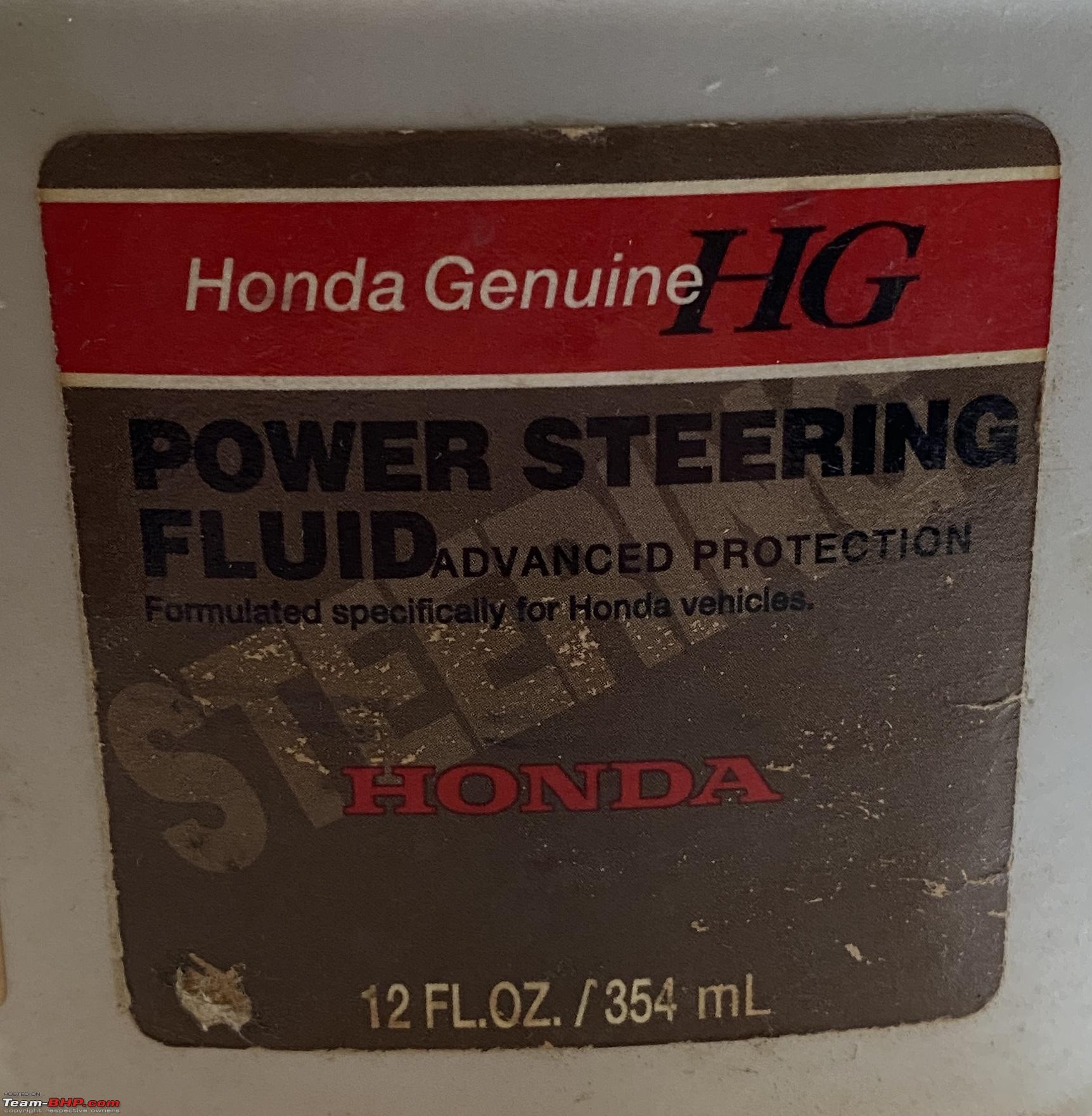

What's the specification for power steering oil for Civic..
In Amazon, it's listing brans like waxpol and Bosch..but not sure which one is compatible
I got the below one from Amazon.in as the level was showing low after about ten years. The steering started making sounds which prompted me to check the level after it was pointed out by experts on the forum.
Honda Civic : Maintenance, Service Costs and Must dos-1fcf94b4b03d48b0a7d666048b691c19.jpeg

I saw similar one, but cost INR 2000.. I guess the one available with HASS is about 600.
But they won't sell

My mechanic actually put this PS fluid(Bosch) into the PS reservoir, it actually works alright:
https://www.amazon.in/Bosch-F002H237...s%2C256&sr=8-6
