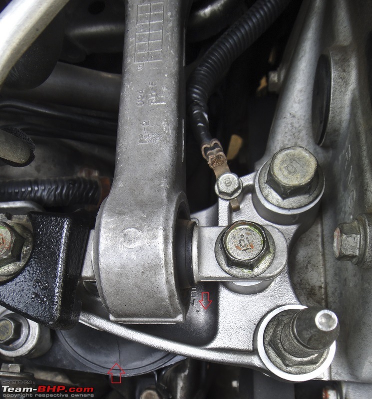

Civic's Engine Mount - How to identify visually for wear and tear.
This component has the dubious distinction of being the most back ordered part of the 8th Generation Civic.
Where to look for the engine mount in the bay

A view from the side of the final assembly

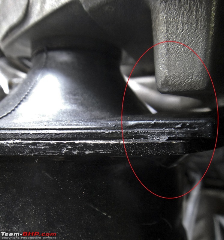

Notice the gap here. This is your cruical indication. This is a perfect scenario now

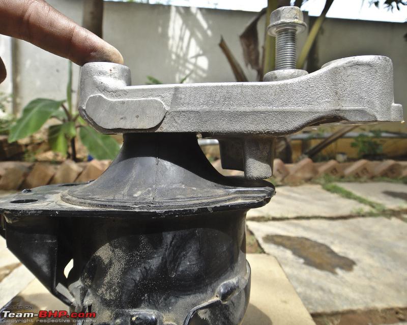

Now let me show you the removed part
This is how it should have been in the assembly
Notice the gap. With the weight of the engine on the alloy part it has already started touching the rubber part below. This touch is the main reason for the vibration and the GR... sounds from the engine bay when you start the engine. More predominant in the mornings on a cold start. Also this results in Thud Thud sounds on jumping potholes.
See the rubber part with the touch of the top part evident

Also see the top part wear and tear due to the touch, the middle c section.

Hope this helps.
Summary
If a Gr..Sound occurs on cold starts, feel the car is front heavy, Thud Thud sound come from the engine bay on jumping pot holes, check this component for wear and tear. Check the gap, check for any visible touch of the top part with the bottom, or if the gap is too small for comfort - You need to consider changing this.
Damages would be Rs 8000/-
