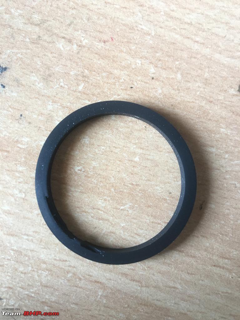

Civic's rear left brake caliper had developed a small leak. It wouldn't leak always but once in a couple of months it would spew out about 20-25ml of fluid and I could see the brake fluid on the rim and even on the ground. I was facing this issue since almost an year so had to check and top up the fluid often. Had a long drive coming up hence took the plunge and replaced the brake caliper seal. During last service at Honda, I asked them about the same. They checked and told me that there isn't any leak (don't blame them since the leak wasn't always there). So, ordered a 'rear disc brake rubber seal set' for Civic from Boodmo and replaced it myself. The rear brake piston is a screw-in piston in the civic and that was the only tricky part to get in back the assembly. Rest of the stuff wasn't too tough but obviously when you are working on the brakes, you need to know what you are doing.
Pictures of the failed seal that was replaced:

The civic has done around 900kms including a highway run of 700 kms after the seal change and everything seems to be good.
Thanks.
