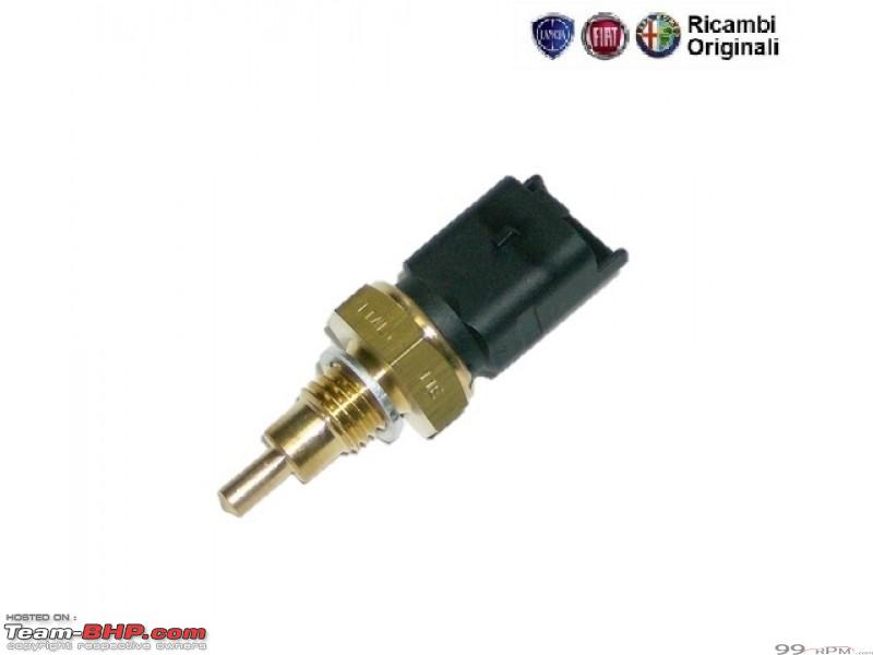

I am back, with a new problem.
After I got the car back for the second time (after getting oil cooler from 99rpm.com), I went on a drive. After covering 70 KMs or so, the engine temperature needle went above the halfway mark. It went down a little after coasting on neutral (at slow speeds, to avoid loss of control) and switching off AC. The needle would go up again when driven with AC on.
I realised that the radiator fan was no longer functioning. Since it was functioning earlier that morning (who can miss that thunderous sound!), I took it back to the same mechanic. He said the thermostat sensor is not working, so the radiator fan is not switching on.
Unfortunately, my car has a 4 pin thermostat sensor. The mechanic checked Swift's. It has 2 pin sensor. Even 99rpm.com shows 2 pin sensor. So I went to KHT Motors service centre. They also showed a 2 pin sensor. Apparently Fiat changed the design from 4 pin sensor (of Tychy made engines) to 2 pin sensor (of Ranjangaon made engines) but retained the same MPN. KHT Motors expressed their helplessness in procuring the 4 pin sensor. Luckily, I knew their manager personally, so he urged his people to find a way out. Finally they found that a similar 4 pin sensor comes in Punto. Now they have ordered it, and I am supposed to get it in 10 days.

Since 10 days were up after KHT Fiat service centre ordered the 4 pin thermostat sensor, I checked with them. I was disappointed to hear that they have received the 2 pin sensor. He has asked me to give him a call in a few days.
Meanwhile, a colleague of mine is going check at Aadya Fiat, as he lives nearby. I don't have much hope though. I have asked another colleague to check in London, as he is there. I believe the possibility of finding this part is higher in London (considering that not only Fiat, but also Lancia, Alfa Romeo, Opel, Suzuki, Ford and Chevrolet make use of this engine).
KHT Fiat do have that sensor in stock, but it is assembled into a bigger part. It is so tightly fitted (in the factory) that the mechanics were unable to unwind it out of that part. If I am not able to get the sensor from Aadya or from UK by this weekend, I am thinking of buying that whole part for ~1500 Rs and breaking it up to extract the thermostat sensor. Hopefully, the new sensor doesn't damaged in the process!
As my manager lives near Aadya Fiat service centre in Bangalore, I gave him the part and asked him to check. But Aadya service personnel's attitude was really annoying. Initially they refused to sell it, saying they don't do over-the-counter sales and I should get the car towed. When I asked him if it is worth spending 10,000 Rs for towing for a part that costs 500 Rs, the guy spoke to his boss. Then they said they cannot sell only the sensor, and I have to buy the whole assembly for 2800 Rs. Not only that, I should also pay for labour even though I am not getting the labour done there. This was absurd!
Fortunately today, I tried searching in 99rpm.com with various search terms and finally stumbled upon this:
http://www.99rpm.com/fiat/coolant-te...-59116563.html
Here is its picture:
I saw the description:
Fiat Genuine Coolant Temperature sensor for Fiat Palio, Siena, palio Stile and Adventure with 1.6 petrol or 1.9 diesel engines. Type: 4 Pins
4 pins, and it looks exactly like the old part from my car. Palio Stile is mentioned in the description too! Unfortunately, it is not listed under the Thermostat parts. I wish I had found it earlier.
I have ordered it. Now keeping my fingers crossed!
