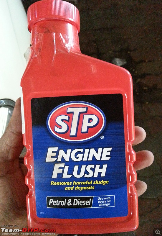

This time I wanted to perform a “mega” flush and hence few days back I had already purchased STP Engine Flush @ Rs.400 from online shop (ebay). The STP mentions of containing Kerosene !
I locally searched for some cheap oil (same grade) and got Techol by Zet Lubricant (Vapi based company), branded to be used on rickshaw (/auto), priced at Rs.200 per ltr. I already had some spare oil - MX, HX5, MM-FEO.
Note: Since the vehicle will be running on idle just few minutes, I took a chance of ignoring the ratings (& brand!) and just ensured that grade was maintained.
Pics of STP Engine Flush and Techol :
All about diesel engine oils-20160103_141323.jpg All about diesel engine oils-20160103_141329.jpg
All about diesel engine oils-20160103_141355.jpg All about diesel engine oils-20160103_141400.jpg
The “mega” flush Process :
I will try to observe the performance of ELF and keep posted. Also, hopefully the “mega” flush did some positive changes :-)

Hi Pranav,
You have mentioned that about 80% of the engine flush was used with the old oil. What was the benefit of that when you were to use a brand new oil for flushing anyways? Could have used the whole flush with the new draining oil.
Also, did you change the oil filter with the flush oil? If no, then you should have definitely used a new oil filter. When you are spending so much on flushing then it's better to use a new filter.
One more thing I would like to ask is when you are happy with one particular brand, then why do you keep on changing the oil brand? Any particular reason for it?
Instead of spending so much amount on mineral oil, wouldn't it be wise if you used synthetic oil. You could have benefited from synthetic oil and at the same time you can extend the drain interval as well. Excuse me for asking a whole lot of questions :)
Originally Posted by auto_enthusiast (Post 3883288)
Hi Pranav,
Hi,
lemme reply :
a) old (existing) oil may have quite lost its detergent (cleaning) properties, but the newer (/flushing) oil will be quite strong with cleaning agents. Hence wanted to "rejuvenate" the old oil, but didnt want to overdo same with newer flushing oil. I have also read some negatives when using harsher properties of flush, so took safe steps ?!
b) existing oil filter may not be really clogged and mostly still hold filtering capabilities. with this assumption, filter was replaced only when filling Final oil. yes, a more meticulous process could involve a new filter even during the flushing process!
c) I like to play and experience different brands of engine oils. Only by such experiments, I could personally feel differences and provide a direct feedback. Someone once said "you should keep trying different shampoo / soap, and not stick to one !" Maybe engine develops an "immunity" by trying different syrups :-)
d) hmm... though this may open can of worms, when talking about Synthetic vs Mineral oil, lemme put it straight : Synthetic costs 3-4 times (or more) than Mineral. My typical driving conditions could easily be met by Mineral. And, I dont think I will keep the drain interval to 3-4 times (15K-20K KM!).
and finally, such processes does give some Kick !
Originally Posted by pcpranav (Post 3883310)
Hi,
lemme reply :
To each his own, but I personally would have preferred to use the flush with the new draining oil coz the old oil itself is deteriorated and dirty and rejuvenating it with flush oil won't be as beneficial as using the flush with a fresh oil and a new filter.
Agreed to your point that synthetic vs mineral is a debatable topic but the single biggest deterrent for synthetics is cost. And anyways you are spending approx. twice the cost of mineral oil along with the additives and draining oil. And instead of the 7k service interval, even if you extend the drain interval to say 10k, which is absolutely normal for synthetics, your cost is more or less covered (synthetic being approx. thrice the cost as compared to minerals).
Regarding the kick it gives you, then it's your game altogether. Play the way you like:D
