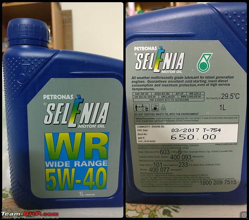

Have purchased this for my Swift ZDi from 99rpm.com.
Name of the Oil: Petronas Selenia WR (Wide Range)
Grade: 5W40
Costs: ₹ 650 per litre
Compatibility of the oil:
  1. ACEA B3/B4;
  2. API CF;
  3. MB 229.3
  4. VW 502.00/505.00
  5. GM-LL-B-025
  6. BMW LONGLIFE-98
  7. FIAT 9.55535 N2 C.T.R. No.: F515.D06
Originally Posted by a4anurag (Post 4226838)
API CF
Hi,
looking at the price, its Fully Synthetic, right ?
this specs looks very outdated, why not something in CH/CI grade ?
regards,
Pranav

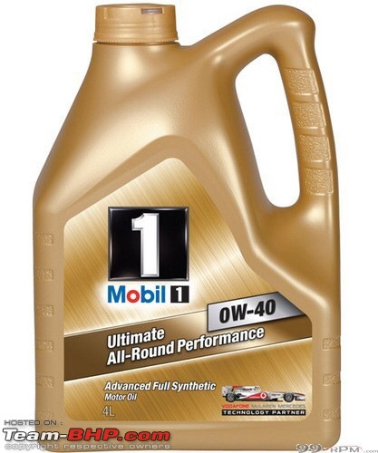

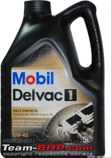

Gentlemen,
For the elite i20 CRDi, which fully synthetic oil would be the recommendation of the gurus here? I'm looking for something which will last long through highway drives and city traffic, and reduce NVH as well.
I've got three choices:

2. Mobil Delvac 1: Fully Synthetic 5W-40
3. Mobil 1 : Fully Synthetic 0W-40
The last item is the most expensive of the lot. 5L of that comes in at nearly 5K.
Till now I've been using the semi synthetic Shell HX-710W-40 oil and it has been pretty good so far. I'd like to get the oil changed to fully synthetic at the next service at 40K.
Is Delvac 1 THE best choice for turbo diesels? Please do let me know. I'll be getting this done within a week so I may need to place the orders soon on 99rpm.
Thanks in advance, cheers!

Hi,
As per my info, i20 CRDi manual specifies ACEA B4 engine oil.
http://www.mginfo.co.uk/upgrades4mgs...explained.html and http://www.oilspecifications.org/acea.php
Shell Helix Ultra 5w40 : ACEA B3/B4 (API CF - old specs for diesel!!)
http://www.shell.in/motorists/oils-l...tra-5w-40.html
Mobil 1 - 0w40 : ACEA B3/B4 (API CF - old specs for diesel!!)
http://www.mobil1.co.in/products/product_0w40.aspx
Mobil Delvac 1 - 5w40 : ACEA E7/E4 (API CI4+ : new specs for diesel, good)
http://www.mobil.sg/AP-English-LCW/h...c-1-5w40.aspx#
have you tried any other in the semi-synthetic range (15w40, API CI4+) like Shell Rimula R4, Mobil Delvac MX ?
regards,
Pranav

Hi,
sorry if I wasn't clear in my earlier post.
As per the ACEA standards, "B" is for (Diesel) Consumer Cars, whereas "E" is for (Diesel) Heavy Duty Vehicles. I believe in most cases, "E" oils are better.
Some of these oils also mention their API standard (provided those oils were also tested against the API standard), wherein CH4 being minimum standard for (Diesel) Consumer Cars, CI4/CI4+ being the recent release gaining popularity, and CJ4 being the latest (see caution for DPF/Sulphur content notes).
Ofcourse, across the oil industry, in each of the grade, there is minimum level specified to comply to that particular grade. Some oils just barely meet those minimum standards, and some oils pass with good score in that same grade range, hence you may see price & performance differences.
Next, for each of your mentioned Fully Synthetic oils, I put their ACEA & API ratings. In this comparison, I feel Mobil Delvac 1 5w40 will best suit your requirements, its ACEA E7/E4 & API CI4+, about Rs.4000 for 5 litres.
(twice I purchased from 99rpm)
In your post you had also mentioned of earlier using Semi-synthetic Shell Helix HX7 10w40, which is ACEA B3/B3 & API CF. I think its pretty base (basic) grade. I would personally use some newer standard, better lube.
And finally, since you had mentioned using Semi-sync in past, I inquired of the more popular R4 and MX. Many people have good opinions for both these semi-synt oils.
Personally, I have tried various of these oils, and you could see my previous posts in this thread.Just for ref, I have a Xylo, 7.3 years with ~185000 KM on ODO. Our colleague "IndigoXLGrandDi" has Xylo ~8 years with ~293000 KM ODO, tried many oils too.
To summarize, in your case, I would suggest Mobil Delvac 1 5w40 CI4+ : good performance & good price. Btw, whats the ODO on your i20 ?
again sorry buddy, if my earlier post wasnt clear.
regards,
Pranav

The odo on the i20 is nearing 40k in 2 years 3 months. Been running on the HX-7 10W40 from Shell all this time. There are no concerns with the car at the moment. So maybe it's my imagination, but I somehow get the feeling that the engine sounds a bit rougher than it used to some 10K kms ago. Hence I'm considering moving to a fully synthetic oil during the next service.
So you recommend the Delvac 1 5W40 right? Hmm, I concur. I've read quite a few posts recommending that oil. And what would you say about getting stuff like EGR cleaning done in the next service? Is that really needed? There's a bit of black smoke that comes up under hard acceleration in the turbo zone. Should I consider using the Liqui Moly diesel purge and whatnot?
Let me know what you think. Your advice seems really pertinent. Thanks!
