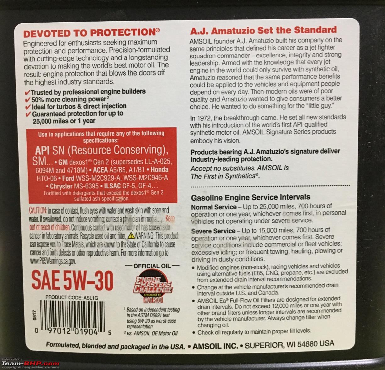

What about this one:
https://www.amazon.in/dp/B00EXBSLBC/...v_ov_lig_dp_it
I'm thinking of getting this for my Ecosport TDCI.
It is a 5w30 A5/B5 so feel free. Technically a petrol only oil if you go by the API specs, but ACEA A5/B5 = petrol + light duty diesel
https://www.oilspecifications.org/acea.php
ACEA A5/B5 Stable, stay-in-grade Engine Oil intended for use at extended Drain Intervals in Passenger Car & Light Duty Van Gasoline & Diesel Engines designed to be capable of using Low Viscosity Oils with HTHS Viscosity of 2.9 to 3.5 mPa*s. These Oils are unsuitable for use in certain Engines - consult vehicle-OEM’s owner’s manual/handbook in case of doubt.
