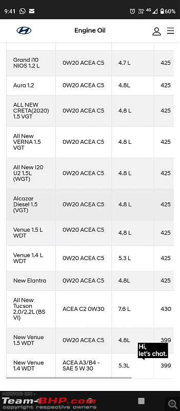

Why is it recommended by the Vehicle Manufacturers to use Low Viscosity Oil in Modern BS-VI Engines?
For example Hyundai recommends to use ACEA C5 0W20 in their BS-VI Diesel Engines (except Tucson where ACEA C2 0W30 is recommended) in India as shown in the below image taken from HMIL website-
How does 0W20 or 0W30 Grade withstand the Ambient Temperatures of 40+Degrees at various places in India? Or is this just a New Gimmick used by the Manufacturers to force the Customers to mandatorily bring their BS-VI Vehicles to ASCs as Such Oils cost a bomb in Aftermarket?:Frustrati
What happens if API CI4/CI4+ SAE 15W40 or 10W40 Diesel Engine Oil is used instead?

ACEA C5, C2 and C3 etc are mid SaPS engine oils complying with low emission standards to protect the exhaust aftertreatment systems such as DPF (Diesel Particulate Filters) found in Euro VI diesel engines.
API CI4/CI4+ (that typically carries ACEA E7/E9) or passenger car ACEA A3/B4 are not mid SaPS. They are high SaPS oils not suitable for Euro VI engines in terms of damaging the DPF.
For cheaper alternative that complies with Euro VI engine emission requirement (hence would not cause damage to DPF), one could opt for another mid-SaPS in ACEA C3 engine oils which are generally easily available at a cheaper price and offer a far thicker viscosity in terms of engine component protection.

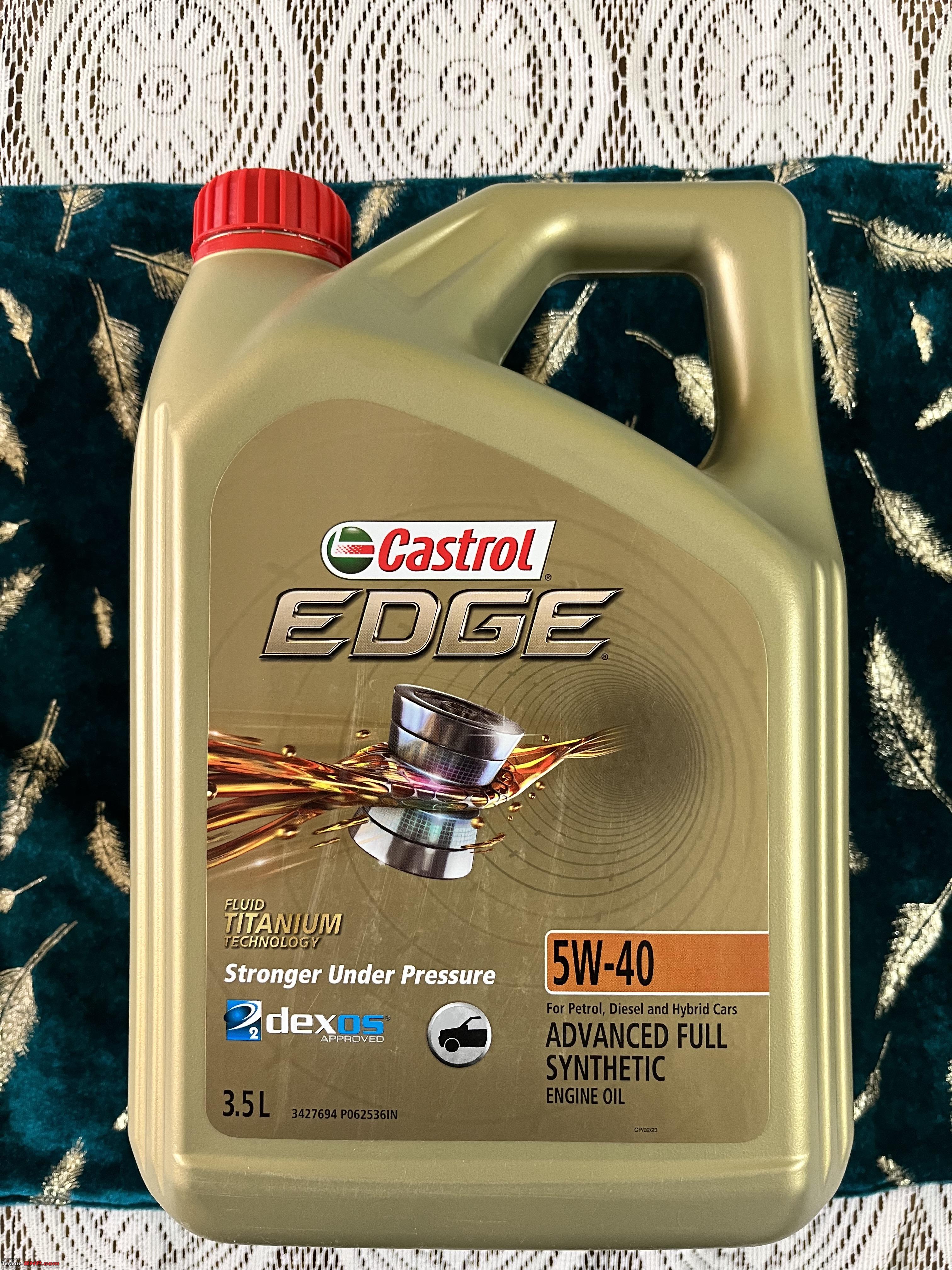

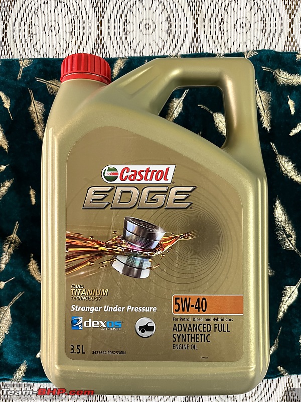

Purchased Castrol Edge 5w40 for my Swift 1.3 DDIS. This time bought the oil from a Castrol authorized dealer in my hometown (Ghaziabad). No discounts and was costlier than the same available on Amazon/Boodmo. But the peace of mind of genuine oil trumps any monetary benefits. Costed 3500 for 3.5 L.
Edge has changed the ACEA specification from A3/B4 to C3 now. As I looked it up C3 is more advanced and probably backward compatible with A3/B4.
I did also confirm over mail with Castrol folks that the oil is indeed genuine.
Will be changing this tomorrow or day after myself :Cheering:
