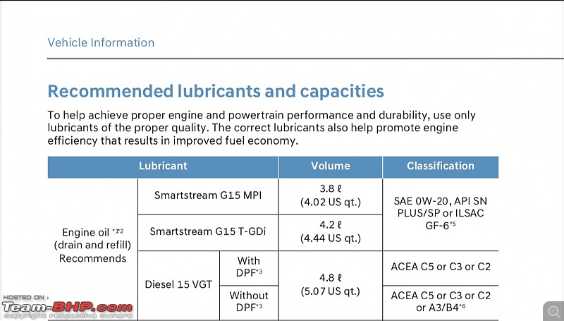

Dear Colonel sir, my apologies for the late response. I was a bit occupied due to a personal situation.
Hyundai specifies that we can use either C5, C3 or C2 grade oil in the diesel engine. They also provide a range of oils that can be used depending on the temperature range the vehicle is used in.
I spoke to the service manager who mentioned that oil dilution isn’t a problem (I don’t think he could’ve anything other than this that can be quoted against him :coldsweat). He was of the opinion that changing the oil at 5k interval isn’t necessary and asked me to stick to the regular service interval. I then spoke to the service advisor who checked the oil level which was at the exact max level and was not above it. He also told that the oil quality was still good and not to change it now (the running was 5400kms). He rather asked me to get the oil service done at around 8000-8500 mark and go for the fully synthetic oil (0w30). So, that is what I’ve decided to do.
So here's what a 0w20 oil looks like after barely 6000 km. Almost as thin as water. Nod politely to the SA, then after 5000 or so km just change oil to a ACEA C3 5w30 or 5w40 somewhere outside using an OEM filter.
I am not entirely sure how this oil is going to run for the suggested 15000 km.
