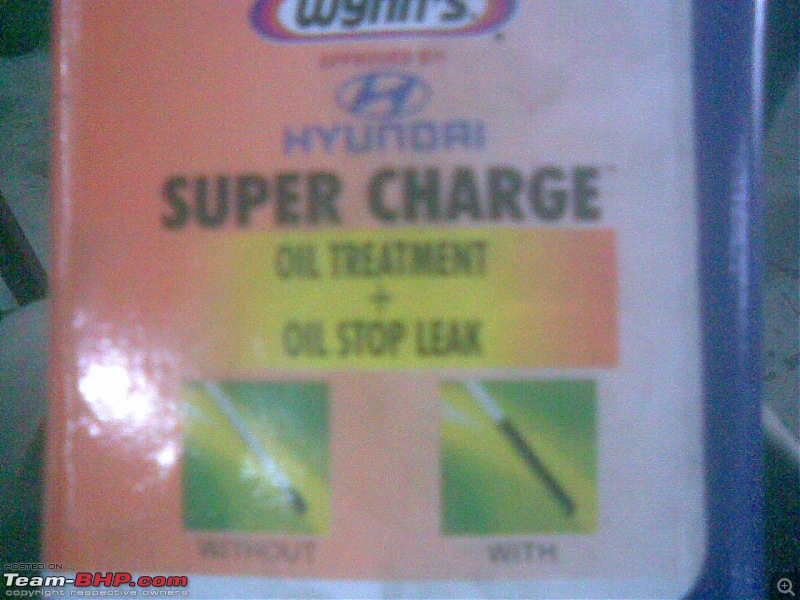

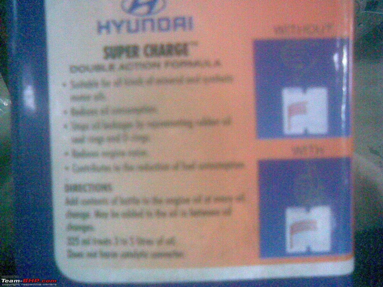

- Wynn's Engine Oil Additive 325 ml @ Rs.395/- (approved by Hyundai)
Below Pics of front & back; image quality bad because of my low res mobile cam (Mods: if you could approve these images?)
- Diesel Filter (for NEF CRDe) Rs.1707
- Wynn's High Performance Lubricant Supplement additive for Gear and Transmission oils (approved by Hyundai): 125ml for Rs.395: one tube in each compartment.
