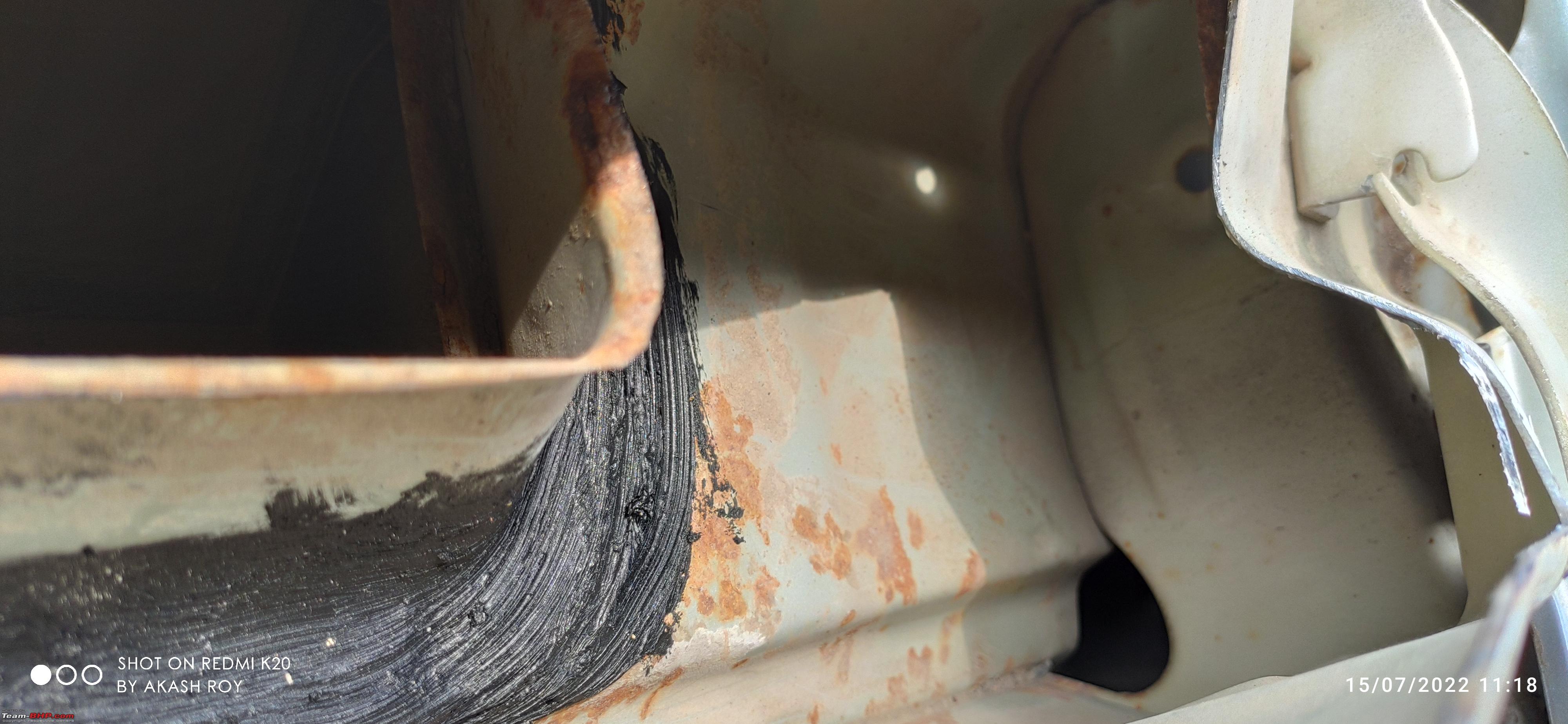

Another issue cropped up in the Alto thanks to the incessant rainfall recorded in Gujarat this week.
The dreaded Water Seepage inside the car! After all the diagnosis, took the car to the fng bodywork shop to cut open the cowl section above the fresh air manifold suspecting a hole due to rust. Found no holes there. Totally confused how it the water seeping inside from the dashboard somewhere near the glovebox.
Any suggestions would be welcome.
