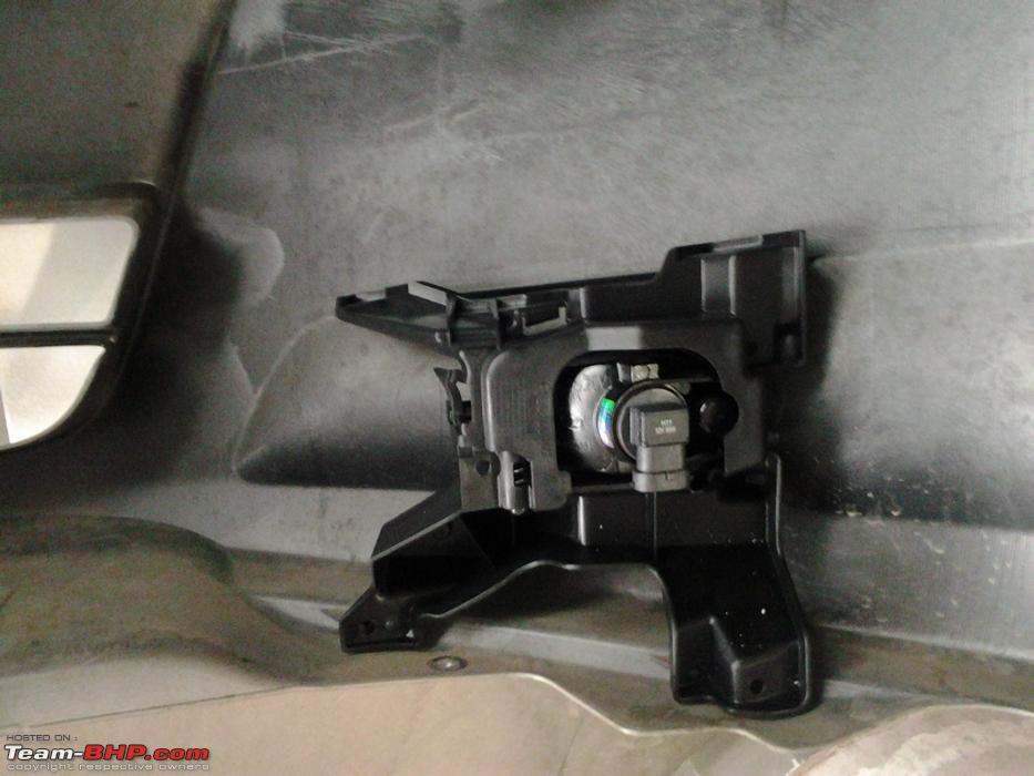

Time to get the fog lamps fitted...
Take off the bumper and invert it and you will see that there are markings present for cutting the fog lamps inlays. All mounts are also present to enable you to install the lights..
Picked up my New Honda City! Update: Low GC & Headlight woes addressed-20120121-14.38.57.jpg
Picked up my New Honda City! Update: Low GC & Headlight woes addressed-20120121-14.49.21.jpg

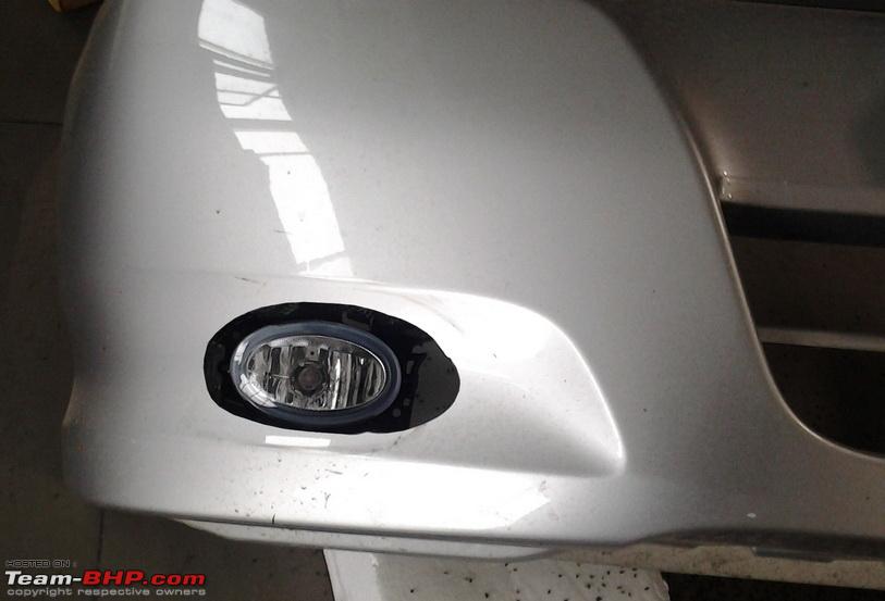

After a rough cut.. needs to be filed for a better finish..
Picked up my New Honda City! Update: Low GC & Headlight woes addressed-20120121-14.57.56.jpg
Now with the lamp in place..
Picked up my New Honda City! Update: Low GC & Headlight woes addressed-20120121-15.03.jpg
