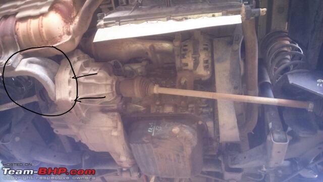

The car has completed 46000kms now. A bit less, because the Accord was used for the last few outstation trips.
Last evening as I drove back ho e from the BMR, I noticed a problem. Whenever I revv the engine high in a gear, there is a weird noise heard, some kind of grating maybe. As I depress the clutch, the sound is gone till I upshift, and then again it comes back when I revv it higher.
I shifted to neutral and just pressed the accelerator and again I can hear it on high revvs.
The acceleration has been good, no noticeable loss of pickup, but then after noticing this issue I didn't indulge in any spirited driving. The gears are shifting normally. The issue wasn't there yesterday morning when I drove to the rally. It might have come up during the rally, as there were a couple of wheel spins on the ramps of the NSCI, but I wasn't in a position to notice.
What could be the fault? Clutch or gearbox or somethjng loose?

Took the car to the local Tata service centre and they diagnosed it to be the loose silencer bracket. The car was hoisted on a lift and we found the two bolts locking the bracket into the transmission housing had sheared off.
The bracket:
My Nanovation : Tata Nano-20150209-13.27.04edit.jpg
You can see the bolts sheared off - shown with circles.
My Nanovation : Tata Nano-20150209-13.25.29edit.jpg
honeybee is offline   (1) Thanks

The bracket was fixed, a headlight bulb and a foglight bulb were replaced and the total damages came to Rs. 1350/= So it's not exactly cheap if the bracket gets loose like this, specially if the bolts have sheared off. The lathe wala's charges were Rs. 600/= for the two bolts.
