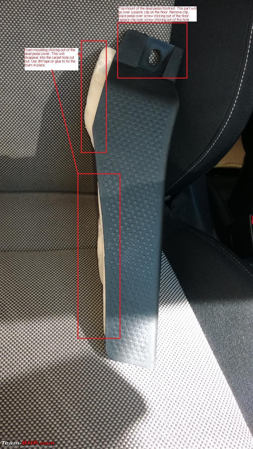

Dead Pedal Install Process - A little more complicated than you think.
Step 1- Remove the plastic clip/nut on top of the trim next to the steering column cover on the floor of the car. (to find out which, align the pedal on the floor and see where the top hole aligns to. Fix the foam backing in the plastic holder and put it in place so that the top hole lines up with the mounting point above the pedals. You will see that the pedal sticks out from the foam moulding a bit. This is OK.
Step 2- draw an outline on the carpet (covering the floor and transmission tunnel) of the pedal.
Step 3- cut the carpet out and expose the metal floor and transmission tunnel.
Step 4- fix the foam part in place on the exposed metal using any glue/3m tape of ur choice.
Step 5- Put the carpet back around the foam moulding. Fix the dead pedal on top of the foam moulding, bottom part clips into the foam moulding, top part aligns to the screw on top which gets covered by the nut.
VW Polo GT TSI - Officially Unofficial Review and Initial Ownership Report-wp_20131009_002.jpg
End result.. my left foot hasn't been happier...
