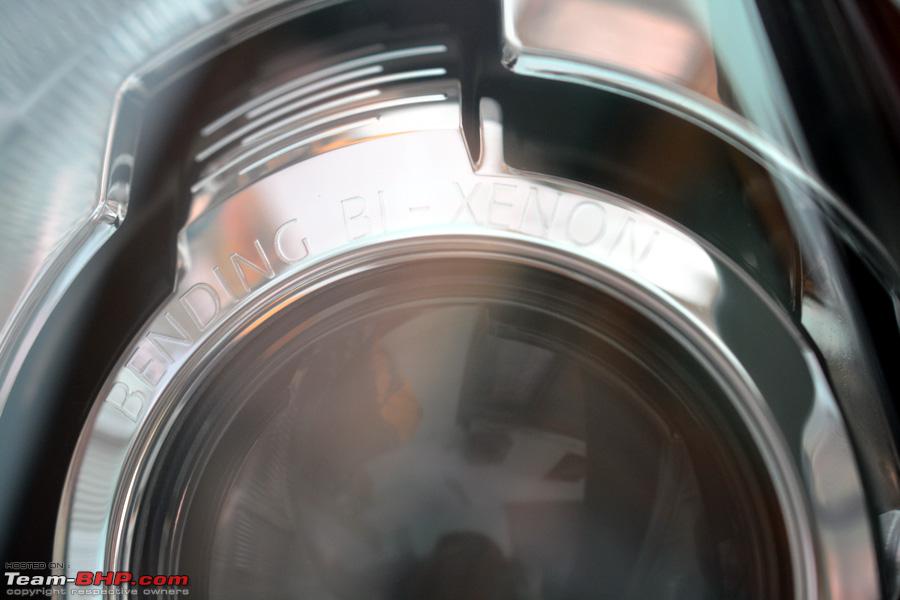

One quick question. Is the bixenon setup similar to the one on the Octavia? I ask because when i checked it had a halogen light which turned on when using high beam.

The Superb's Bi-Xenon is similar to the Octavia. Additionally the Halogen high beam will also come on along with the Xenons. Halogens have a better throw as far as my experience in the Laura goes. The Octavia has only one lens, hence no Halogen.

Thanks adi. I did Check again. I'm somehow not convinced that they are bixenons. It does stay on in high beam but I don't see any change in the beam. The beam seems to be the same in low and high. The only difference in high beam is that the halogens come on too. Am I missing something here?

The term Bi-Xenon is confusing. Bi-Xenon is basically marketing jargon for a projector headlight that activates a solenoid when the High beams are activated. The solenoid in the projector moves downwards, allowing for more light in the projector bowl to actually escape through the magnified glass. This basically provides a "high" beam even though it is still the same beam. This is how it is in the Superb and the new Octavia. AFAIK in the Laura & Jetta the Xenon works only for low beam.
A lot of cars have Halogen high beams to supplement the Xenon/HID (Superb/New Octavia) or to act as the sole high beam (Laura/Jetta). Xenon/HIDs are not very suitable as separate high beams since they have a longer warm up time and flashing them drastically reduces their lifespan. A lot of cars also have a halogen beam to complement the HID/Xenon with a solenoid (aka bi-xenon as in the Superb).
Hope that clears your doubts...

Thanks for that. I do get what you are saying. What got me thinking is that in the Audi A4, a shift from the low beam to high beam is noticeable . You can see a flicker and change in the path of the beam. But that did not happen in the superb. Anyway I will take a good look at it again .

Skoda Explains this as follows -
ŠKODA Superb Bi-Xenon Headlamps with AFS
AFS (Adaptive Frontlight System) represents top technology, which based on the current driving conditions and the speed of the car enables automatic headlights adjustment. The system is capable of working in different regimes:
- Extra-urban - regime similar to a standard dimmed lights.
- Urban - wider and shorter spread of the light.
- Motorway - long light persistence.
The front lights also include the rain function, which you will welcome during low visibility operations and even during a snowstorm.
The AFS also includes rotation of the headlamps when driving through a curve plus fog headlamps with Corner function.
Bi-xenon headlamps with LED daytime running lights (DRL) perfectly match the overall dynamic concept of the vehicle's front section. LED diodes are located in two vertical rows on the outer edge of the headlamp, which make the car clearly visible and catch the eye with letter C shaped illumination, so far known only with the rear lights.
Now if you will look closely inside the Skoda headlamp, you should see this -
Driven: 2nd-gen Skoda Superb (2014)-superb-bending-bixenon_1.jpg
This shot is from my 2012 Superb and similar should be visible in the new facelifted 2014 model
Driven: 2nd-gen Skoda Superb (2014)-superb-bending-bixenon_2.jpg
These are Bending Bi-Xenons. Their effect may not be immediately visible at idle but their effect changes with speed, light conditions, rain etc. The same single headlamp fitted with a solenoid acts as a high beam at higher speeds and the halogen bulb supplements the high beam effect. This is how it is in the Superb and similar should be there in the New Octavia. AFAIK this is absent in the current Jetta and the Laura i.e. in layman terms, the bending effect.
Hope that clarifies.
