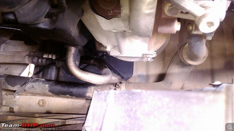

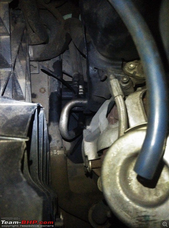

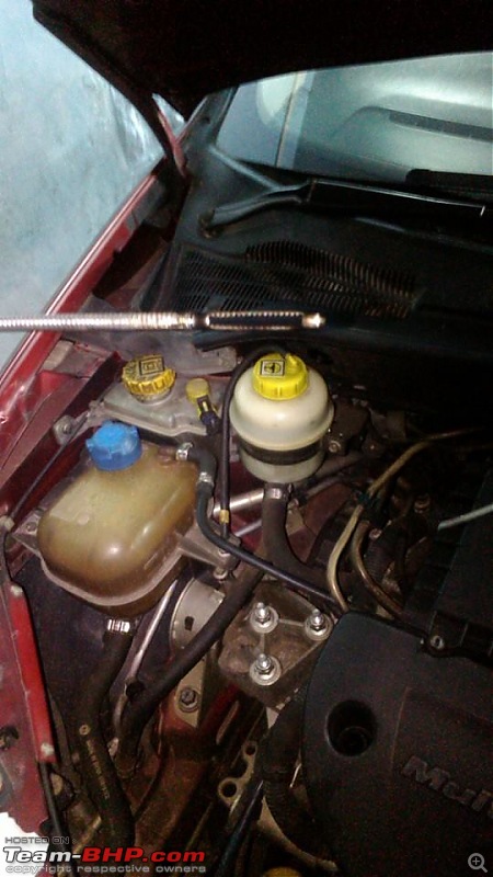

SoS, my FIAT Linea's Oil is leaking.
Looked like ~40 drops overnight and 10-20 drops per hour after todays drive when I parked somewhere. I checked the dipstick & it showed adequate level.
Its in the front part of the floor of engine bay. The drops seem to be mostly on the protection plate.
The 2014 Fiat Linea Facelift - Test Drive & Review-front-portion-engine-bay.jpg
Zeroed in on this nut where it seems to be leaking from :
Oil level as of right now - Dipstick
There as no such leaking before oil change this Tuesday. As usual for Linea apparently 3.3L was filled.
Oil on Lower Engine area:
The 2014 Fiat Linea Facelift - Test Drive & Review-floor.jpgThe 2014 Fiat Linea Facelift - Test Drive & Review-protection-plate.jpg

Looks as if it is the drain plug and it has not been screwed in correctly post the oil drainage. Get it back to the service centre and if you are lucky a simple unscrewing , straightening and screwing back on will do the trick. If the chap who screwed it on has managed to cut a thread or half then it will be a headache and could be an expensive one unless the service centre owes up and takes care of it. If required mail the same to the Boffin at FIAT who is in charge of service and warranties etc, his name is in several threads here. Best of luck
khoj is offline   (1) Thanks
Thanks, will do that 1st thing tomorrow morning. *Fingers Crossed*
Actually I got abit scared because there was a Rubber O-Ring (~4cm diameter) on the floor where my Linea was being serviced.
Though the mechanic said its not from my car, I was a tiny bit doubtful.
*Fingers Crossed* Hope its just a loose nut!

Update : Wasn't leaking from oil drain nut. It was OLD oil spilled onto the engine guard from the Oil Filter while changing it.
*Relieved*
Again service team was very concerned & responsive. Car was immediately raised, checked, oil-sump sourroundings cleaned & re-checked with engine running.
In a way this also showed the service team is always prepared even for immediate / urgent diagnosis. to KHT
