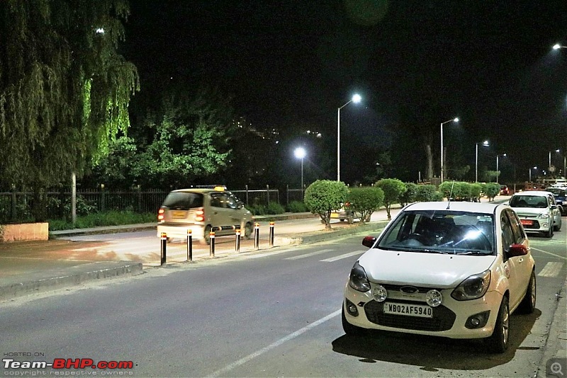

The Hella(s) illuminating those Late Night Drives back home :
My Diesel Ford Figo Zxi - 3 years, 64,000 km and gone-p_20161231_185132_1.jpg
The Figo has been toiling hard on a daily basis and biting rugged miles these days. Times have been tough for both of us these days and we are just complimenting each other's company is tough situations. All we do at times is just share a smile !!
