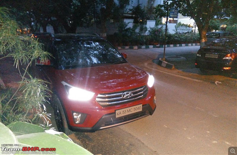

Last Mod hopefully - HID Kit from OSRAM.
The white light from the HID now goes very well with the LED lights. Cost me 11K.

Thanks for the update. Can you share the performance of the osram hids? Also, it would be great if you post some pictures of the low, high beam and cut off. Also, how was the installation? There seems to be some a small drilling that's required on the dust cover to run the wires. Can you share some pictures of that as well and how was the entire installation (the drilling part is what am concerned of). Sorry for too many questions. I need to install this next month.

Sure. I will post the pictures. Need to take them tonight.
Installation took about 60 minutes. Have to remove the front bumper which is held together with 2 buttons and 4 screws and 4 bolts after which it is all lock mechanism which has to be released. The headlamps are also easy to dismantle which are held together by 2 bolts each.
Each ballast roughly measures 3"x3"x1". There are 2 nice empty flat areas next to the battery on the left and the the wiper liquid sump on the right (as if it was custom made for this). There are 4 pre drilled holes in that place already (don't know why). My electrician stuck the ballasts to the surface with 3M stickers and then secured with Zip ties using the pre-existing holes. Very Ingenious guy. (the ones they use for locking our luggages in the airport). I will take some pictures and post it. No drilling done absolutely !

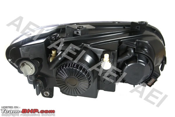

Are you sure on this? Because I had checked the headlights and all wires run inside the headlight assembly and a main power chord supplies power (similar to ecosport).
Something like this:
Hyundai Creta SX+ Automatic - Initial Ownership Report-velowbeaminstall03.jpg

Can you check this and let me know if it's something similar or am I missing something? Would be great if you could share the pictures. Anyways, you got it done and looks . Waiting for more pictures.

Naveen, You are right I mistook your question for the Ballast installation. There is a small hole drilled in the dust cover to let the wires go through. It has been sealed though with Sealing sticker. Sorry about the confusion.
