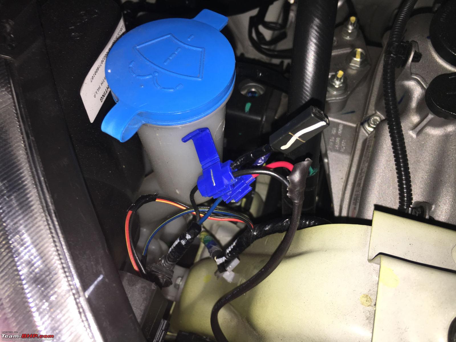

I spent the weekend fixing the harness for the horn, and also readying the wiring harness for the upcoming DRL and Fog lamp project. The mechanic at the dealership had done a shoddy wiring job, and this is what was present:
It was just a pair of wires run around and taped wherever was required. I was not satisfied with it nor did I expect him to do a top notch job since it was beyond the scope of his job and the resources available to him. I only wanted them to be mounted at a proper location which wasnt possible from my side. Now that it was mounted, I did the wiring myself. Prepared this harness with the appropriate connectors and tubing as necessary:
Installed the harness:
Thank god the guy did not cut the horn wire and had made a clean incision into the existing wire and tapped the signal from there. I used a splice connector and tapped the power onto my harness:
However when I took the picture, I had not yet closed the splice connectors, so it looks open.
End of the day, now I have a clean and a reliable setup that will last the entire lifetime of the vehicle instead of the tape job which will hardly last a few seasons.
So I understand that I should get a splice connector, PVC tubing and some connectors.
Now where do I go looking for this stuff, electrical shops?
Basically I wish to prepare this wiring and go to the horn guy and ask him to use my "creation" to wire the horn. But I'm a total noob when it comes to wiring etc. So I'm trying to figure out what all do I need to gather and how do I prepare this wiring?
fine69 is offline   (1) Thanks
Old 28th September 2016, 16:41   #49
Join Date: Jun 2012
Location: BengaLuru
Posts: 5,956
Thanked: 21,234 Times
Re: My Maruti Celerio ZXi(O) AMT - A rare variant
1. Yes, you can get it from electrical shops.
2. Its not PVC but heat shrink tubing. Splice connector is a little difficult to find but you can order them from ebay.
3. Yes, you can create this and lend it to the mechanic, that time the job will be perfect.
audioholic is offline   (2) Thanks
