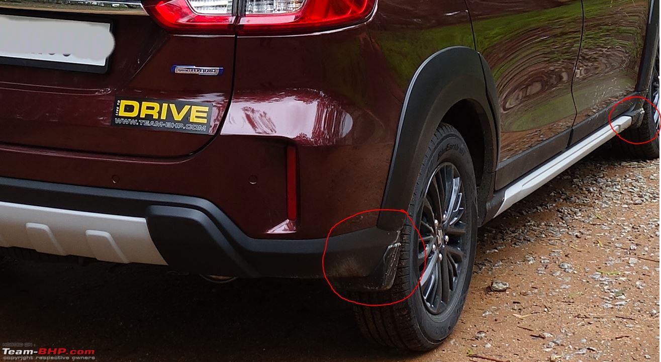

Shashi (and others), any idea about the mud flaps for XL6? Most of the XL6 on road doesn’t seem to have one? Is it not useful?
MGA shop quoted 800/- while the ones on Amazon are available around 500/-
Any opinions about this?
You dont need to install separate mudflaps as the car comes with plastic mudflaps installed. Do check below image and confirm that your car has the same.

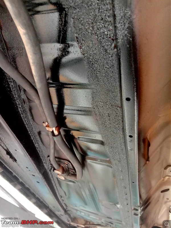

7.13 - Underbody coating
I was in touch with Mr. Lokesh from Swastikaa auto and I finally managed to free-up a Saturday in the last week of August to get the car underbody coated. Reached Swastikaa at 10 am and after a thorough underbody + exterior wash, Lokesh and team used a thinner to wipe and prepare all surfaces before spraying on the anti rust coating. Anti rust coating used was Bardahl Rust Coat and they ensured that a first coat was sprayed on and allowed to dry before spraying the second coat. They also ensured that joins and rough surfaces have a nice thick layer of anti rust coat. Lokesh recommended that I leave the car overnight to dry but I needed the car Sunday early morning , hence it was not an option for me.
For best results, it is recomended that you:
1) Allow the coat to completely dry out, preferably in an area that gets sunlight.
2) Ensure that the coated surface doesn’t come in contact with water for the first 24 hours post application.
Total cost of washing + anti rust coating was INR 4,580/-
Thorough underbody wash in progress
Underbody post wipe down with thinner
First coat on the rough surfaces
First coat on the underbody

Thanks for the inputs Shashi regarding the mud flaps, I had not noticed it, My bad
Saved a few hundreds
