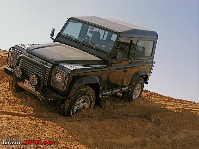

Truck is doing well off-the-road despite some minor issues (including one blown starter).

Just ensure that you don't lose your low-rpm torque with the new halfblock and headers. Great pic.
